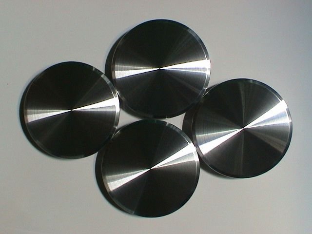

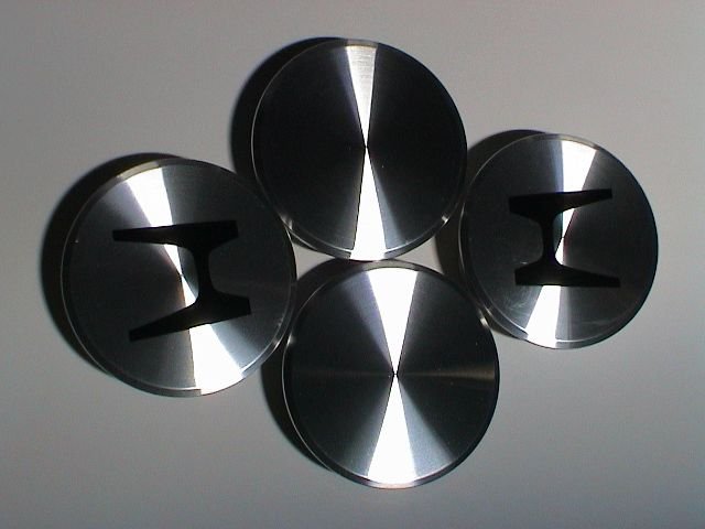

This mod is really easy.
I don't recommend the sharpened chopstick method for removing the wheel caps, or prying them out with a covered screwdriver. I didn't try it, because any error will be visible after the project. It's very easy to remove the wheel and tap out the cap from the inside, and you won't risk scratching the cap, or the wheel.
The OEM clear coat and the black "H" come right off with paint stripper, which doesn't harm the aluminum finish at all.
Because the aluminum scratches so easily, the caps need to be clear coated, just like the wheel. I have to put a few more coats of clear on them, and polish them, then I will reinstall them and show you some final photos.
-Pete
