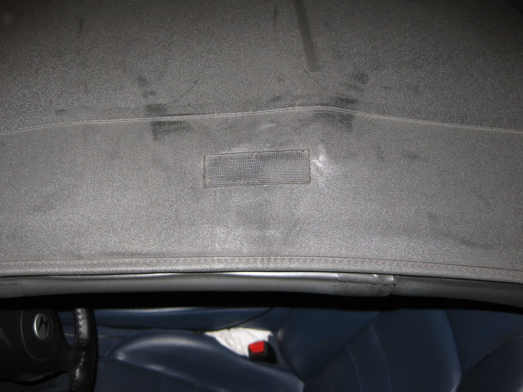

Originally Posted by Incubus,Nov 11 2009, 05:16 PM
To the people with porr results, are you ironing on a patch like the write-up?
I used an iron-on patch but it didn't hold.
Here's some pics of the patch I did:
The waistband material is almost the exact same texture as the vinyl top. It blends in nicely even in sunlight:
Up close with a flash the patch stands out a bit. If you work slowly and don't rush like I did you can avoid all that loose thread that I'll have to clean up later:
Driver's side. I had to do the repair on both sides - at least it's symetrical!
Inside: The hole is much larger than it looks. I used Tear-aid to close it up and hold it together then I sewed the patch over the gash. There's some messy stitching there because I rushed but you can see it can look very clean if you take your time.
Another from the driver's side.
