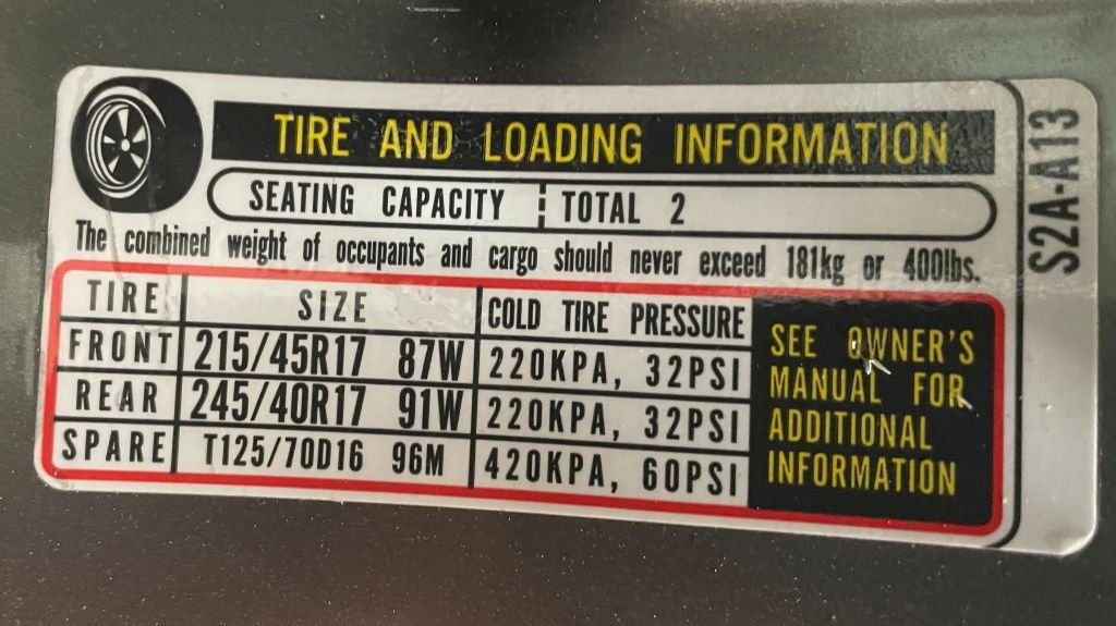

400 pounds maximum capacity for the 2004 and later (17" wheels) cars. Earlier cars may differ but I doubt it.
-- Chuck
Yup, when my wife and I go on one of our trips we are over the 400 LBS limit. Must have 150k miles with the car overloaded.
Rod

Yeah, 400 pounds ain't much. 200 pounds/seat, though seems pretty normal glancing at my cars
Our 4-door Subaru Legacy is rated at 850. And my 3-row (2+3+2) Expedition just under 1500.
But no one looks at the cargo capacity even if they look at the tire pressure specs.
