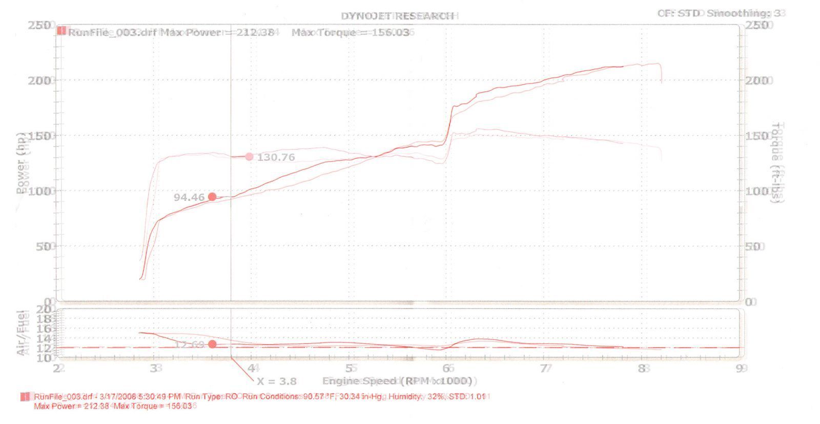

Nice dyno.

sounds about right...my car put 218hp to the wheels on the dynojet

Here is an overlay of the two graphs. It looks like the Berk header wants vtec to kick in at 4800rpms. I say this, because it starts dropping and making less power than stock from 5k-6k.
