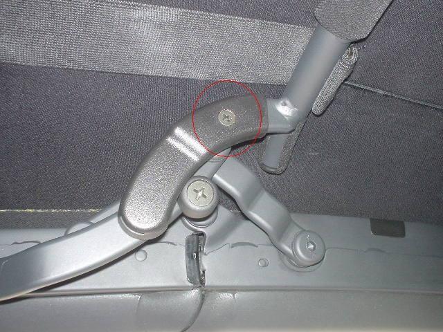

I did a search onthe topic awhile back when i first experienced this problem. Someone had noted that the dealer removed a machine screw from one of the brackets with plastic cover, lubed and retorqued. See attached pic......

the rattle could also be the latches... and not hard to adjust them either.

my dealer replaced my latches/strikers with the hardtop ones
no more rattle
