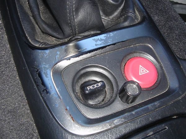

My trim started peeling for some reason. I was wondering if anyone knows if I can buy this piece alone w/o buying a whole new center console.
Its the trim that goes around the shift knob + top/hazard switches.
Its for an ap1

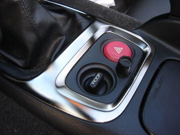

If you're talking about this....
You can use rubbing alcohol and a rag to make it look like this in about 10 minutes.... all personal preference.. I like the shiny look and it will maintain this color as far as I can tell forever...

with the above poster. Looks much better that way anyway.

wow...that looks pretty sweet.
ive seen pictures of this before but i just couldnt remember what was needed to do it. im going to go do it now
thanks.

haha. Never knew it was like that underneath. Is rubbing alcohol the best thing to use?
I guess you could do it around the gauge cluster too then huh??

Rubbing alcohol works fine if your worried about hurting something.
Good question about the cluster. I am curious to that as well.

I did this with mine some years back and if gets just a bit dull just use some more rubbing alcohol on a soft cloth.
PDX S2000
What is the knob between the roof and haxard switch?

Radar detector?

it's a potentiometer (I think that's what it's called? I don't really know)... it controls the level of the amp powering the subs... yes, my car is slow.

bass boost control?
