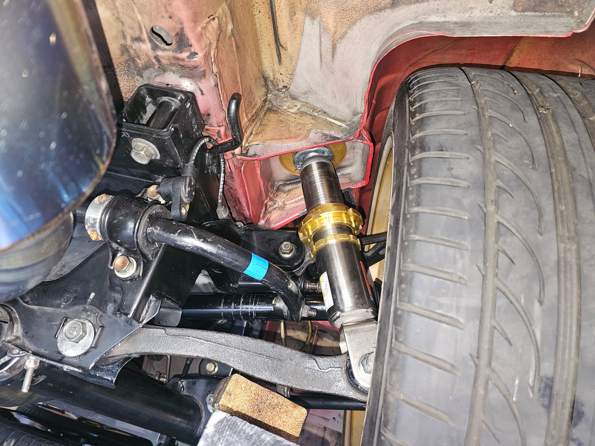

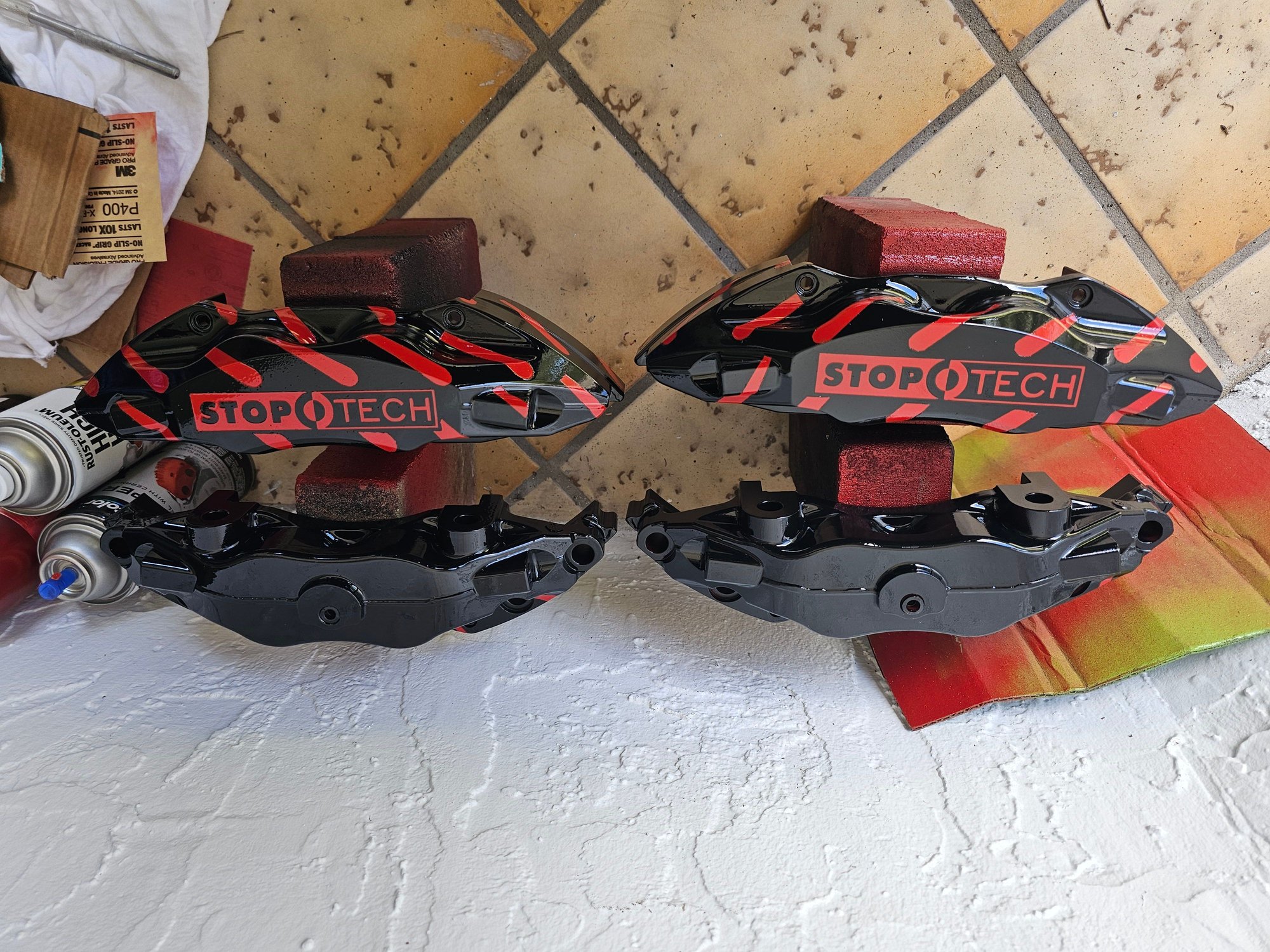

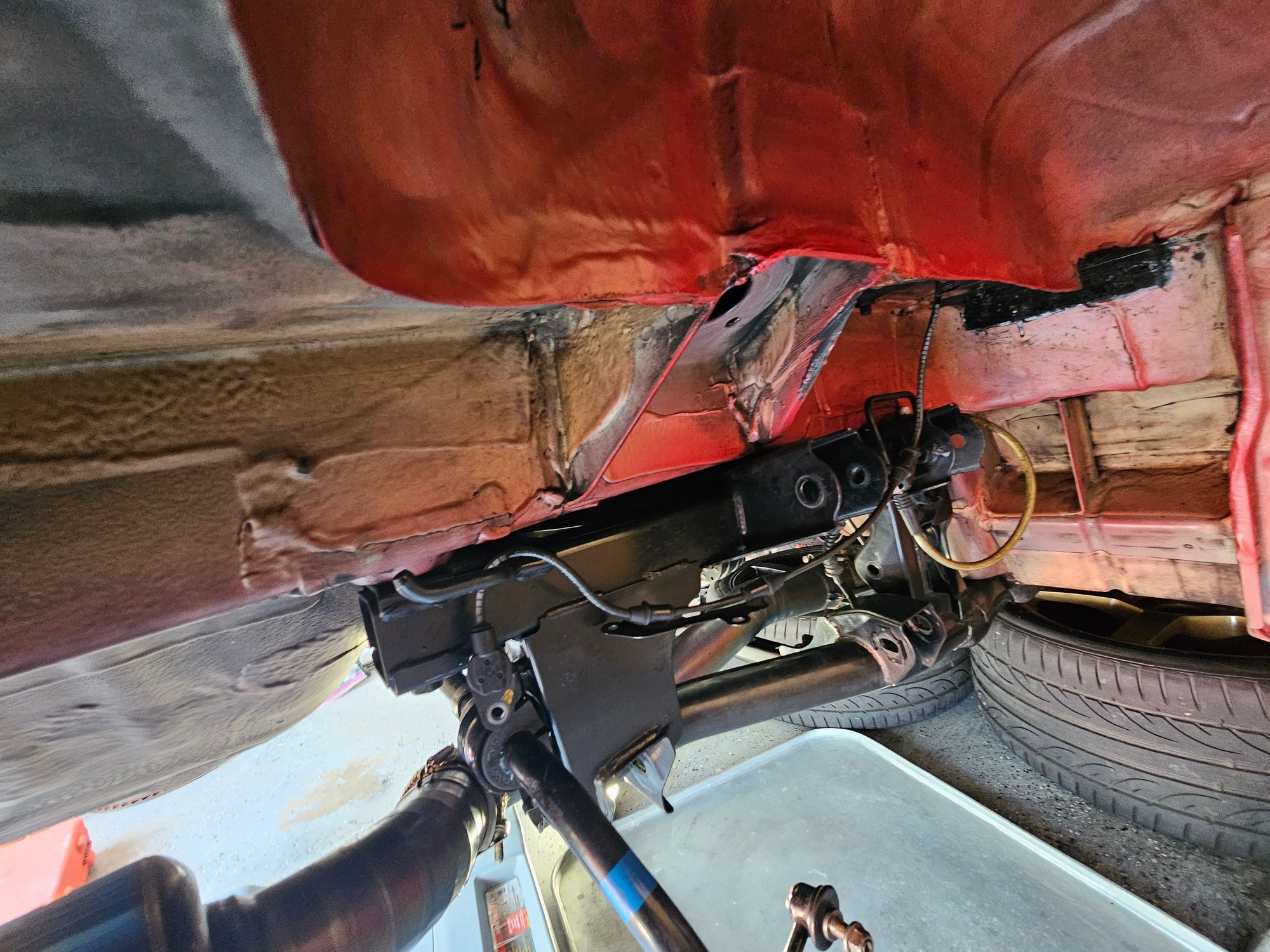

Ive been wanting to post this for months. I got off jackstands and drove the S2 for the first time in 8 months. One of the reasons I hadnt been tracking was concern for wear items around the chassis. I also needed to grease the throwout bearing. Was only suposed to be down 3 months but so little money and time with children. Stripped the suspension and:
Sent dampers for testing (Anze - good)
Scrubbed the wheel wells and under body clean
Greased all suspension bushings
Rebuilt and painted all 4 brake calipers
R&R trans to grease throwout bearing sleeve
New fender liners
New lower shock mount bushings.
New rear UCA bushings
4x New hubs and wheel bearings and wheel studs
Rebuilt axels
Re-hung the exaust for the 4th time
Car now sits 3/8" lower than before. I setup the dampers with new bumpstops and engineered front and rear to engage the bump stops right before crashing onto the chassis unlike HKS's out of box setup with 255 e55 tire/offset.
First start after 8 months and had a cyl 4 misfire. Resistance check, noid light, afr check later found inj with a stuck closed pintle so tapped on the side of it with a punch untill it woke up.
Phew. Its good to be back. Just need RComps for the new wheels to track again.

nice work!
I was just under the car swapping the exhaust for next week. My wheel wells need redoing, I’d love to strip the car down and respray the whole underbody. I’ve seen others do it, tremendous amount of elbow grease but she’s worth it. Might be the deciding factor whether I build my own workshop or not.
