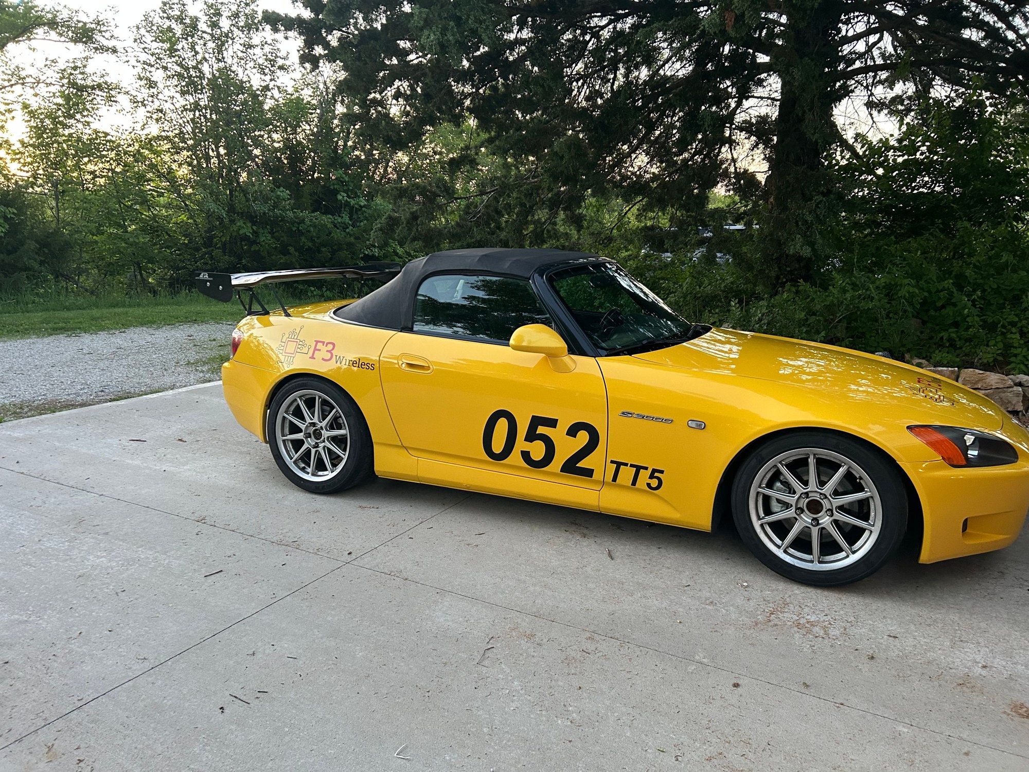

Put the numbers/class letters on it last night.
Tonight will be doing a few prep things on it for this weekends event. Pulling passenger seat to shed a bit of weight (I am way over weight/power for my class, especially for running street tires vs hoosiers). Going to bleed brakes as well and swap pads if my new pads get here today.
