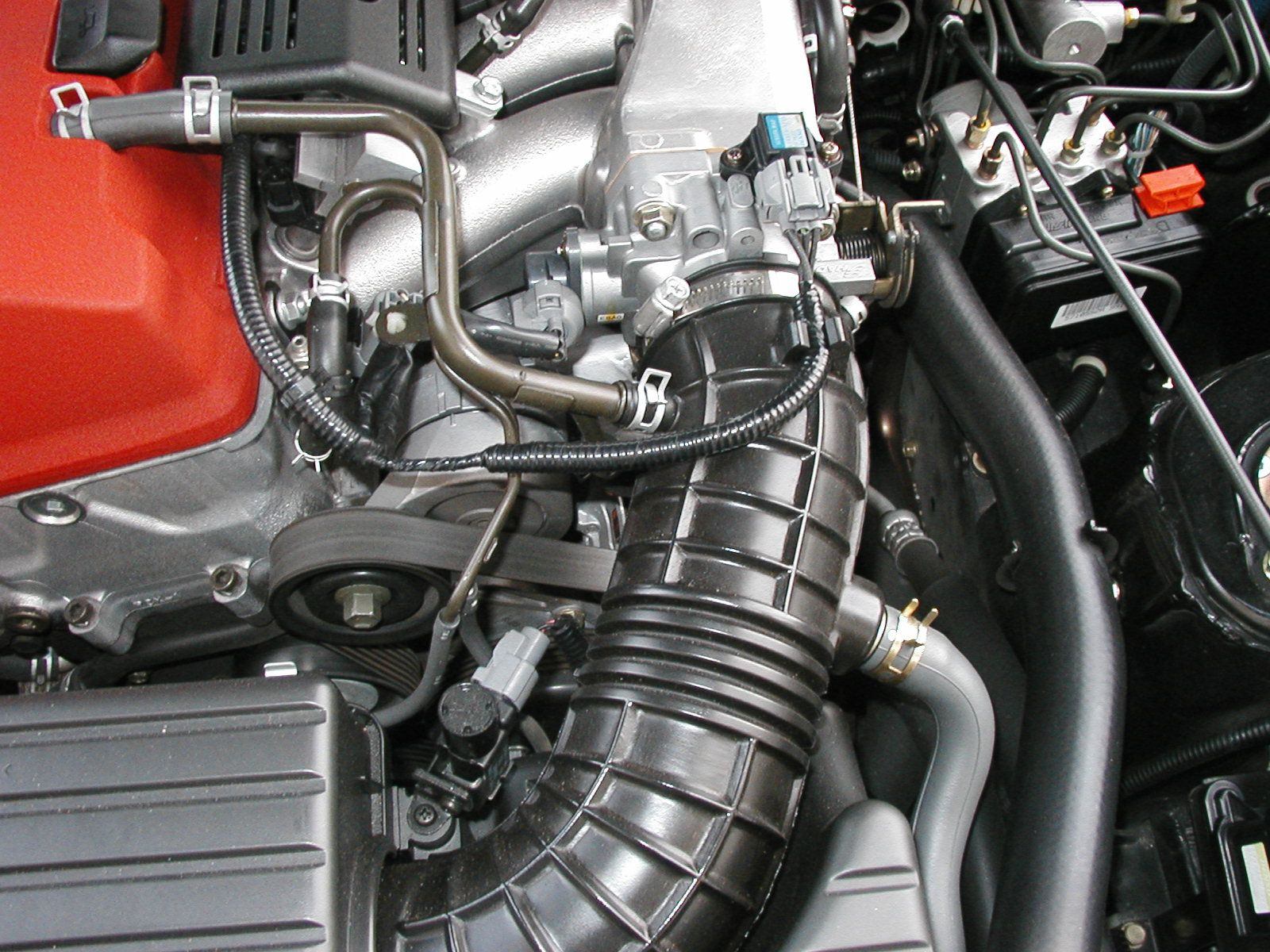

Below is my engine bay back when it was 100% stock.
You can see that there are some differences in the clamps used on your hoses, and the way the metal pipes are oriented.
My assumption is that you got the car used, the previous owner had an aftermarket intake, and they didn't put all the OEM stuff back properly.
The little hose with lots of green gunk on both ends carries coolant - looks like one of the clamps (both of which are the wrong kind, btw) is loose. I can't tell you exactly how, but you need to put things back properly, clean it all up, and make sure you top off your coolant overflow reservoir if necessary.
