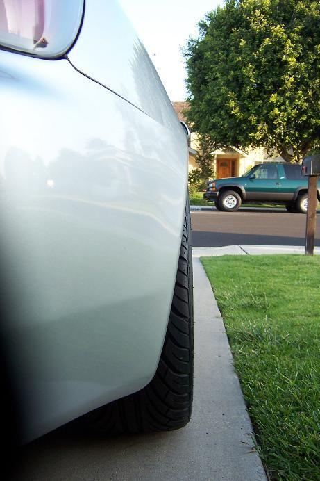

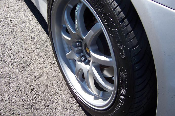

Here's the specs that I am running right now...
17x7.5 +42 with 215/45/17
17x8.5 +42 with 245/40/17
With an estimate 1'' drop on my coilovers and moderate dampening, I do not rub at all. My other suspension settings are pretty much stock as well. I am going to roll my fenders, and see if I can go down another 1/2''.
