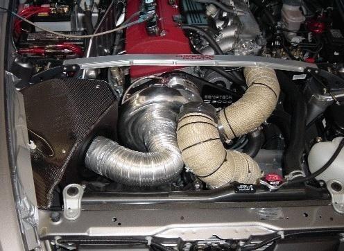

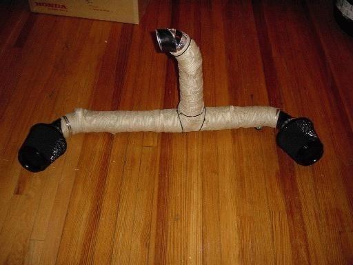

Before I installed the Comptech filterbox, I experimented with an insulated aluminum dual-filtered system that put two filters right at each of my opened "faux-vents":
I insultaed it bacause it ran right by the radiator and coolant lines.
My point: with filters right at cold-air openings... I gained 0 HP. I ran dyno pulls with the Comptech filterbox + big fan and then my custom setup + big fan and there was no difference:
The hose from the Comptech box is not the "real" one... that was just dryer hosing/duct tape for quick experimental purposes.
Seriously HeNeSSey, there's not a lot I haven't tried... so just ask. I will be able to say what worked, didn't work, or what was such a pain in the butt that it just wasn't worth it.
HOWEVER, please do run things that I say/do by other people to get second opinions. I am a hobbyist and not a professional <-- disclaimer

.....testing could not be completed however as his wife had to do a load of laundry and took the ducting back off his car (LOL) .
Nice pioneering Shaner...
Utah
Old Mar 2, 2002 | 06:42 AM
shaner's Avatar
Posts: 968
From: Port Washington
...AND she took the dryer lint catcher from the Comptech filterbox! Women!
