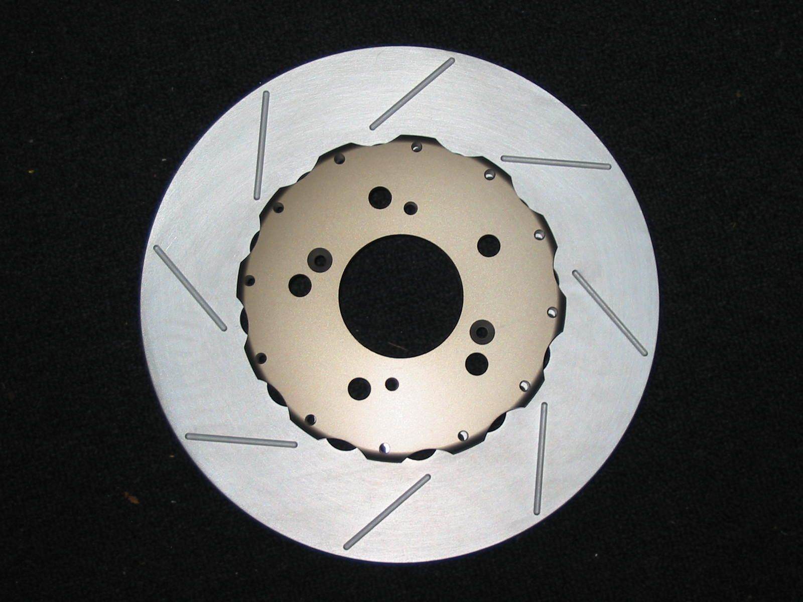

Hey guys,
A friend of mine has a set of AP Racing 2 pc. rotors off a rsx ... will it fit? The spoon callipers are supposed to be compatible so I don't see why the rotors aren't too. Opinions anyone?
Thanks
John
Old Mar 1, 2004 | 07:52 PM
docofmind's Avatar
Posts: 1,792
From: encino
The RSX type S and the S2000 share the same rotor dimensions but the offset on the hat are different. The RSX hats sit deeper, so NO, they are not compatible.

I would be interested in OEM size two peice rotor. Al hat? Slotted? Plated? Front and rear?
Old Mar 2, 2004 | 08:12 AM
docofmind's Avatar
Posts: 1,792
From: encino
2 piece heavy duty race rotor. Rotor has been slotted, cryogenically frozen, and CAD plated. The rotors are also directionally vaned. Hats are also hard anodized.
