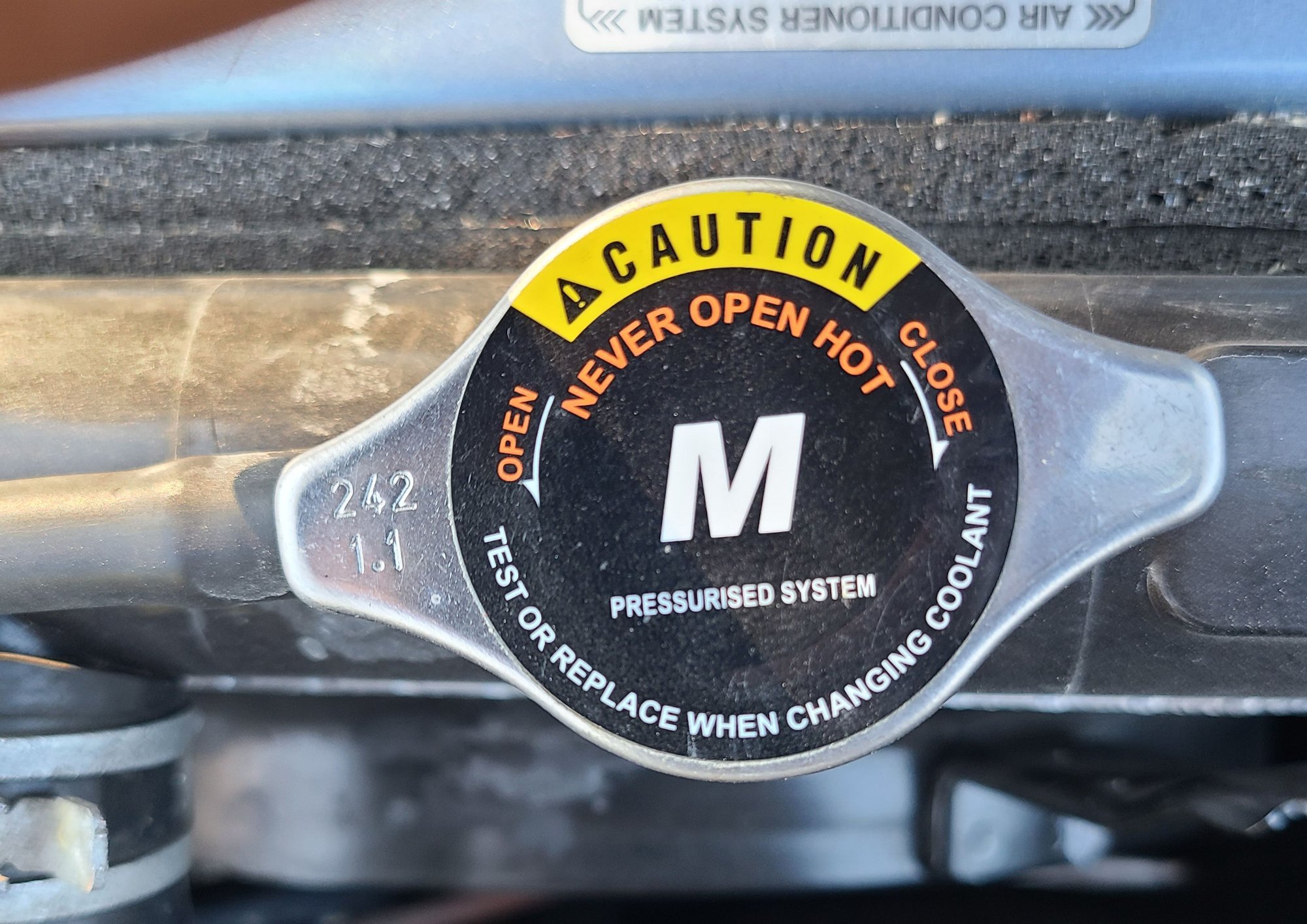

+1 w/JBamin, Car Analogy. I now have a 2004 AP2. I needed to replace the radiator and cap after a mechanic checked it, and the cap spring fell into the radiator. Not the mechanic's fault, parts fail after so many miles. I have about double the miles you have. Anyway, they were honest and told me. I ended up replacing the radiator and cap. I am using a cap from Oreilly's (Murry's P/N: 7037, alternate is 7737 and both are 16PSI) and it is still working with the radiator. I picked up the radiator at local Performance Radiator in the PNW. (p/n: 2720) FYI, I tried using another blue Japanese car coolant and it just needed to be added more often than usual. I recommend using Honda genuine coolant as you should not have to top it off nearly as much. Lastly, use the Billman bleed method. I did, and have not had an issue so far.
