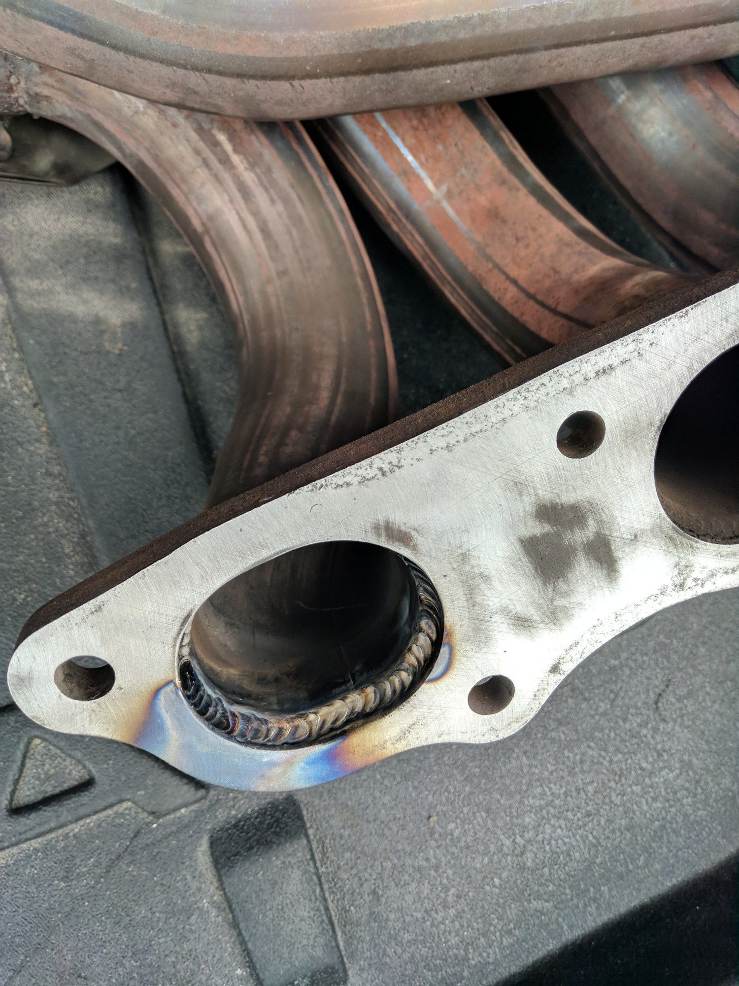

All welded up courtesy of @roel03
Let's see how she does!!

I've noticed the stock manifold and exhaust seem to collect a ton of cracks in them (or at least mine have/did), I didn't even think about this possibility. Nice catch!
I have never heard that but good to know, this car pretty much exclusively gets used on the track so it's not super surprising. Let this be a lesson to everyone else!
