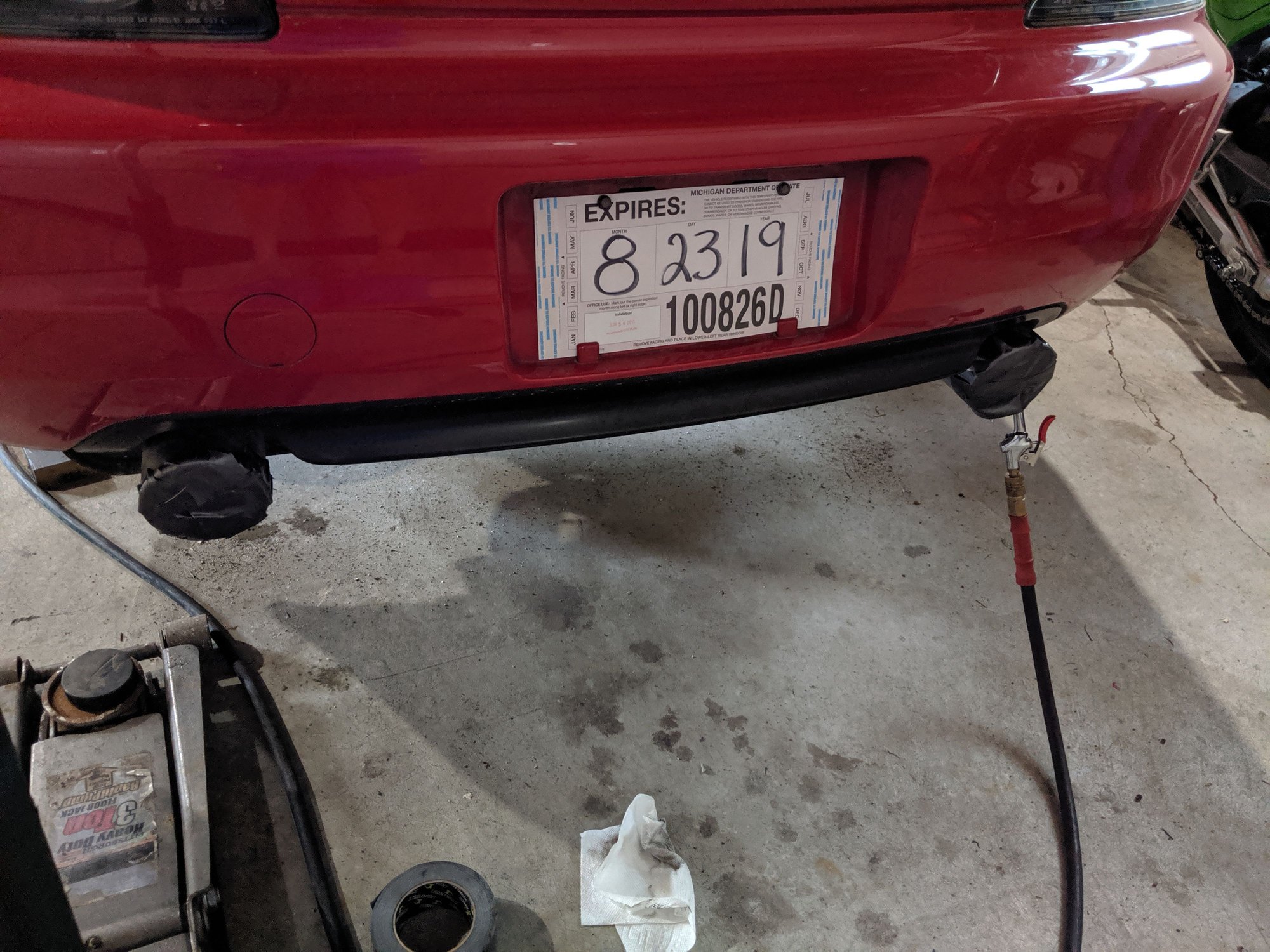

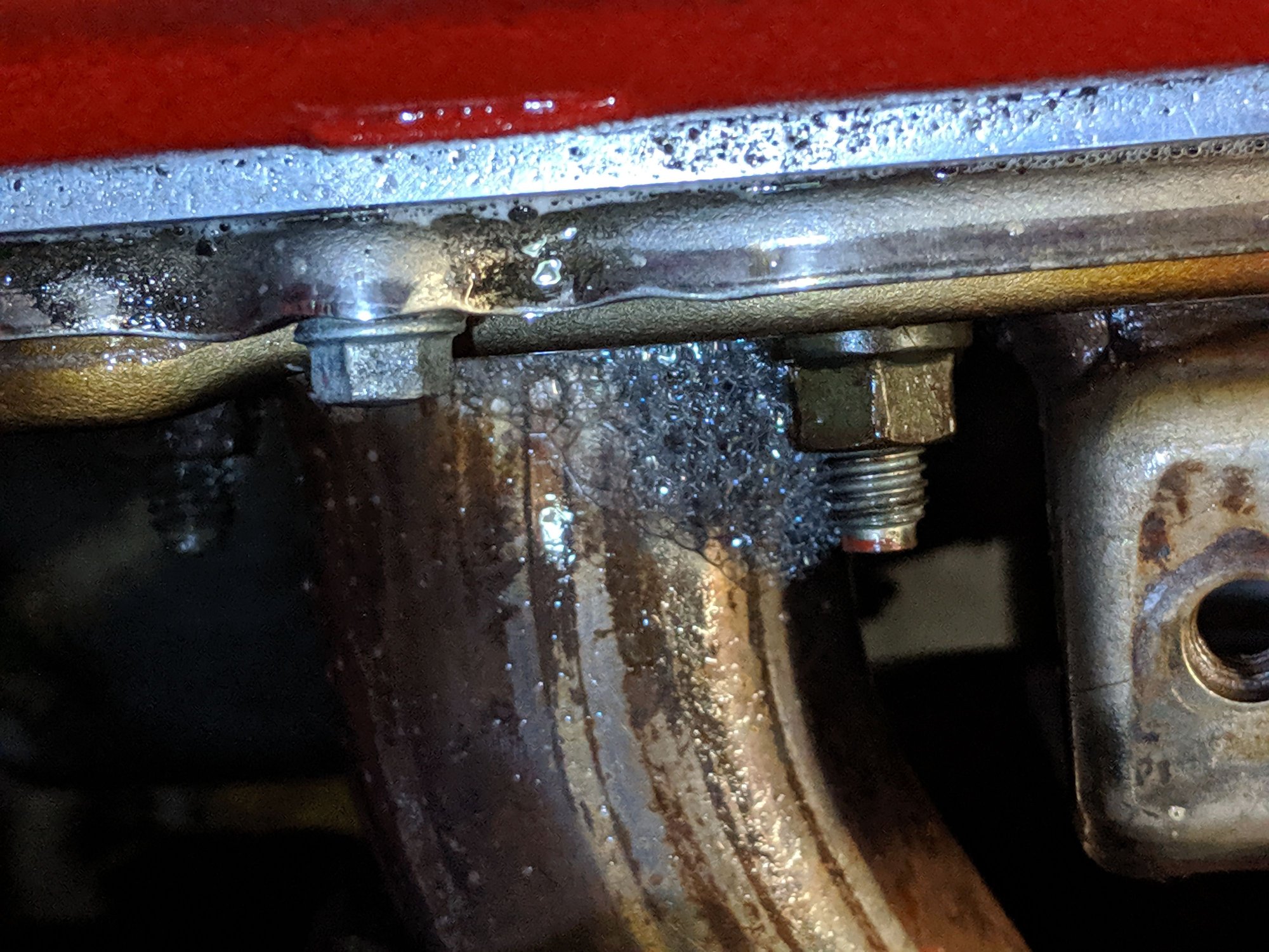

Think I found my problem. Big time exhaust manifold leak.

Well, unmetered air reaching the oxygen sensor will make it think the mixture is lean, increasing the fuel trim.

Yep it's an OEM manifold. Never heard of this before. Time for a new one. Wild!

Nice find, is it leaking between manifold and head or is it cracks/holes in the actual manifold?

Looks like it's the actual manifold from what I saw.

never thought to plug up the exhaust and do that..gonna have to try.

Um, what's coming out of it?
