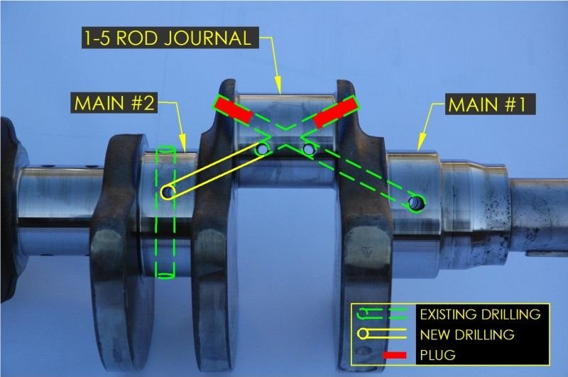

The black fluid is most likely residue from the blind holes in the Crankshaft. Every crank shaft is cross drilled several times to create the oil channels for the Rod- and Main bearings. The Holes gets plugged at the the end, creating partially blind holes.
The heavier dirt particles in the oil get collected in this blind holes over time by centrifugal forces when the engine is running. This is no big deal, as the oil passes the oil fliter first wich catches all parts big enough to cause wear before it reaches crtitcal parts.
When you look closeley at the crank, you maybe could see the plugs.
Reading through classic car magazines, this "System" is noted often. There where old Motorcycle engines wich relied on this as the only system of oil Filtering, there where bolts fitted at the end of the oil channels. The owner shcould dissasemble the engine, remove the bolts in the crankshaft and clean these blind holes from time to time. Mostly italian manufacturers used this system. Go figure you have to dissasemble your engine to do the job every 20.000 Miles or risk heavy wear on the the engine.
What a wonderfull, handy invention a Paper oil filter is...

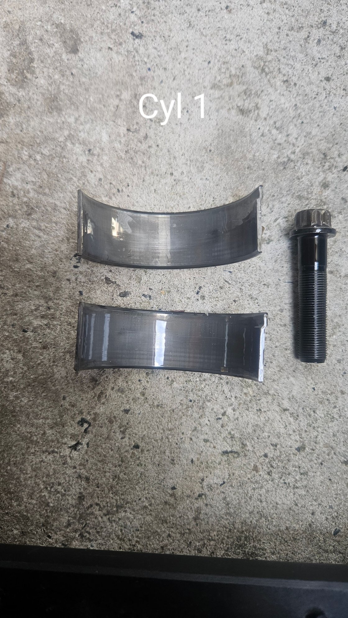

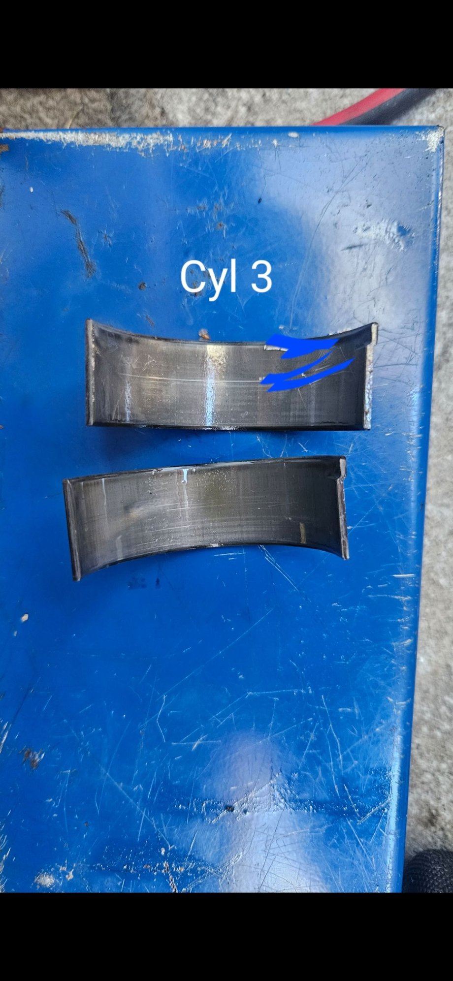

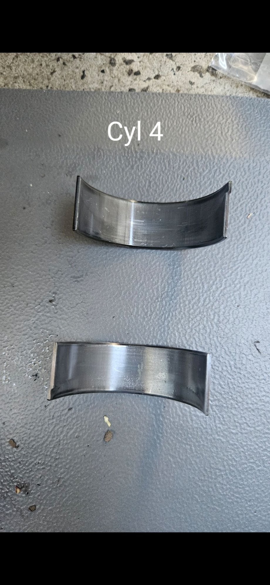

Final summary of rod bearing condition in the pictures below.
marks on/around the blue line were caused by me

Update: I have driven the vehicle 30km on the new bearings and all seems to be good despite the (repaired) damage I caused to one of the journals - still kicking myself over this mistake, but I have ran this past numerous people/AI and both seem to think that there will be a near zero impact on future reliability - Alas, I plan to replace the timing chain (for the hell of it) once I hit 200,000km (it will take a while) and I will replace the bearings again at this stage. Assuming the repair holds, we will see if additional wear is impacting the bearing.
I have noticed that I no longer see an oil pressure light for 1-2 seconds on startup.
I picked out one of the bearings in the above pictures and sanded it with 800 grit as an experiment - I could not get down to the copper material (assuming it is there) in any reasonable timeframe. This indicated to me that there is some substantial (but not critical) wear to cylinder 4 (above).
Accordingly, I recommend that owners replace their bearings at 100k miles (160,000 kilometers), especially if driven spiritedly/tracked. If not tracked or subjected to high load for extended periods of time, you could probably wait longer.
