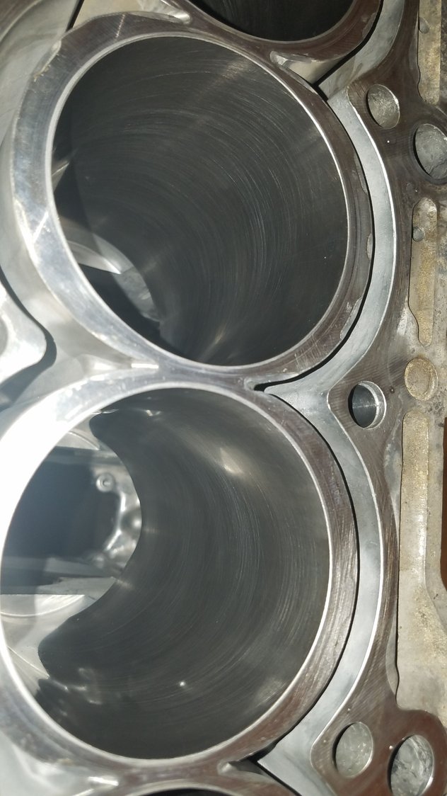

There it is.... 87.25mm

What was that honed with?

I believe they used diamond stones. Also learned that the Nippon piston pins are not DLC coated, so they are not compatible with the OEM rods. Fortunately, the OEM pins fit the Nippon pistons. Another option is to simply apply the needed coating to the pins.
