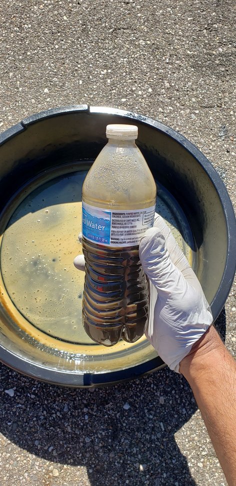

Since we've descended into catch cans...
I have likely the most cunning set of catch cans on the planet in order to catch and store all the oil my over the hill, high amount of blowby engine barfed out.
While also keeping it stank free and using coolant warmth to keep the moisture in check.
This is (2) 15-20 min sessions worth of oil catch.

Now you've all got me curious. What is the legitimate use case of a catch can? It's just to prevent oil directly going from the PCV into the intake manifold, right? But even if that happens... outside of a flash of white smoke, what's the downside? I don't think the oil in the catch can goes back into the engine anyways, so the oil consumption isn't alleviated.

You are correct that catch cans do not alleviate consumption. They just change where the oil goes. In normal day to day driving without a catch can it just gets burned through combustion via the PCV system. With the advent of emissions rules the old days of just venting to atmosphere went away and thus, it gets routed back to the intake. And it causes zero issues, does not rob you of any measurable amount of power, etc.
Now, using the car off normal use, like on a track is another story sometimes. The AP1 is a lot worse about it due to the baffle design. The sloshing and high G cornering causes a lot higher amount of oil to go through the PCV as normal, so you make a hard right hander, go WOT down the straight and then crop dust the entire straight. This can get you black flagged and can cause you to panic if you do not know what is going on. So on track, the catch can prevents that part. Baffle mod solves most all of it.
Or like B Serious showed above, if your track car just has excessive blowby this can also create more than the normal amount of vapor going through the PCV
I honestly have never driven mine hard enough on the street to create this issue. I would argue even canyon carvers do not really need to worry about a catch can. Worst case you see some smoke now and then but not going to be massive and not going to cause issues. But, I tend to do my super hard driving on track, not on the street. I will do some spirited driving on the street, but nothing like the 85-90 mph hard right hand corners at limit of grip type thing it sees on track, when this issue really pops up.
