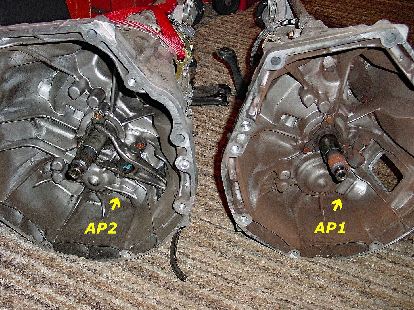

Just to be sure.

I posted that pic a long time ago, note the reinforced webbing that climbs up around the countershaft area.

Yeah, I copped the photo off the Net and put in the arrows and notes.

I know that area well, that cot dang circlip from hell is right in that recess. You need to spread it open to remove the countershaft.
