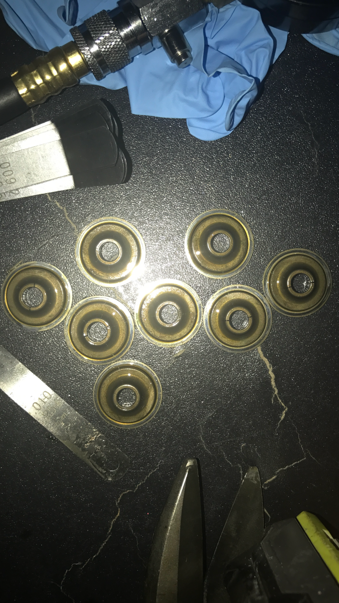

take photos of the intake side, post them up, and we'll give an assessment. I'm in the same boat and pull the valve cover every year- every time, all looks well. I have not over revved on a down shift and so the stock AP1 retainers remain healthy. I have a set of AP2 intake parts ready to go, but i'll keep them in the packages. No need to change them if I don't need to.

I Have a 1999 S2, when I got the car about 5 years ago it had 30k miles, I changed the intake retainers about 40k miles I think. To me this was just an insurance policy, I could not guarantee that in the cars past it had not been over revved, the retainers looked ok but swapped them anyway. Your choice..
I have only found 1 broken exhaust retainer. The crack was very small and hard to see. The intake retainers on the same engine were destroyed bad. This is from a high rpm mis shift.
So if your intakes APPEAR ok, your exhausts are guaranteed to be fine.
I am currently at 150k on original AP1 retainers. Proper inspection is key.
