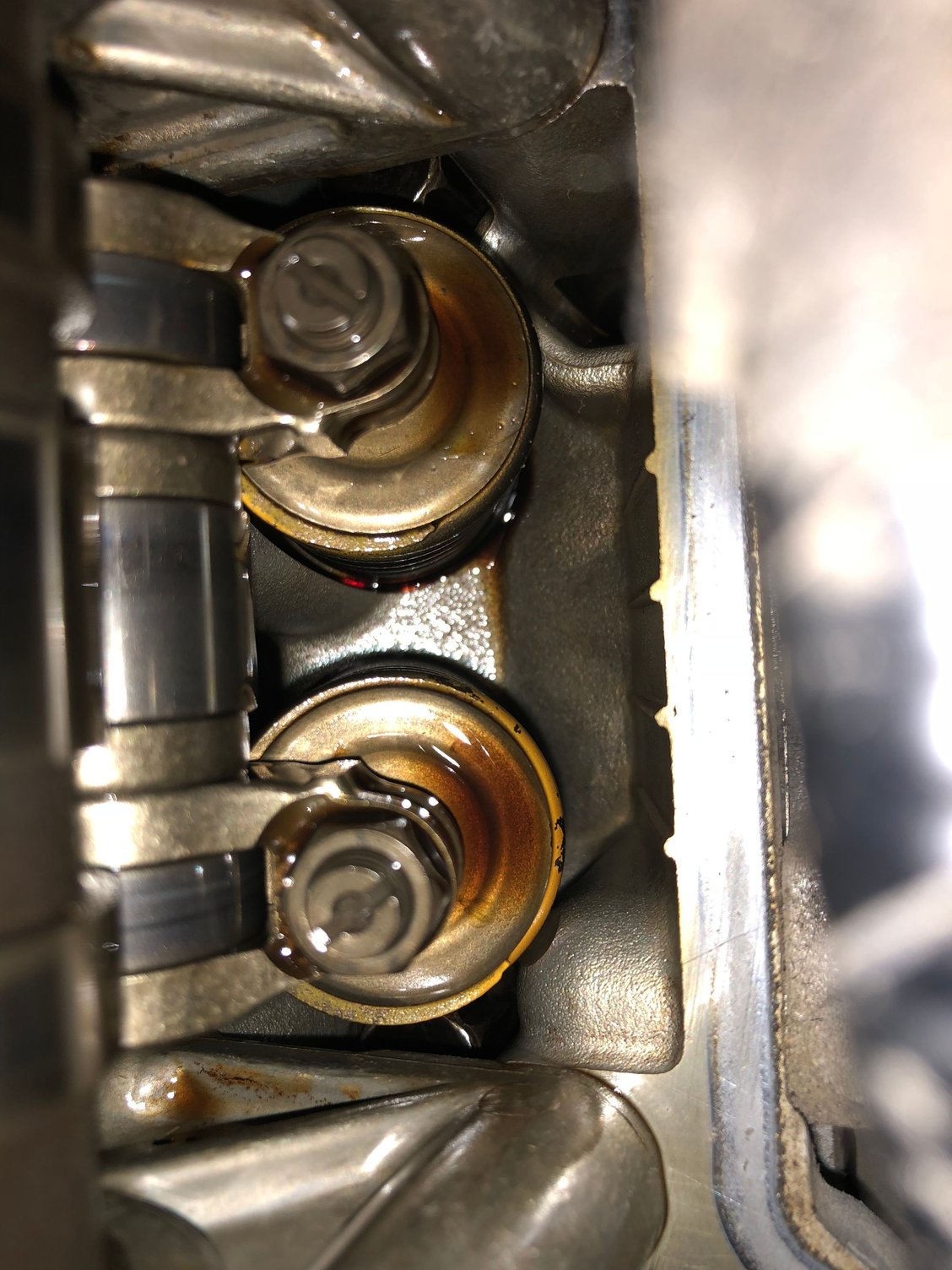

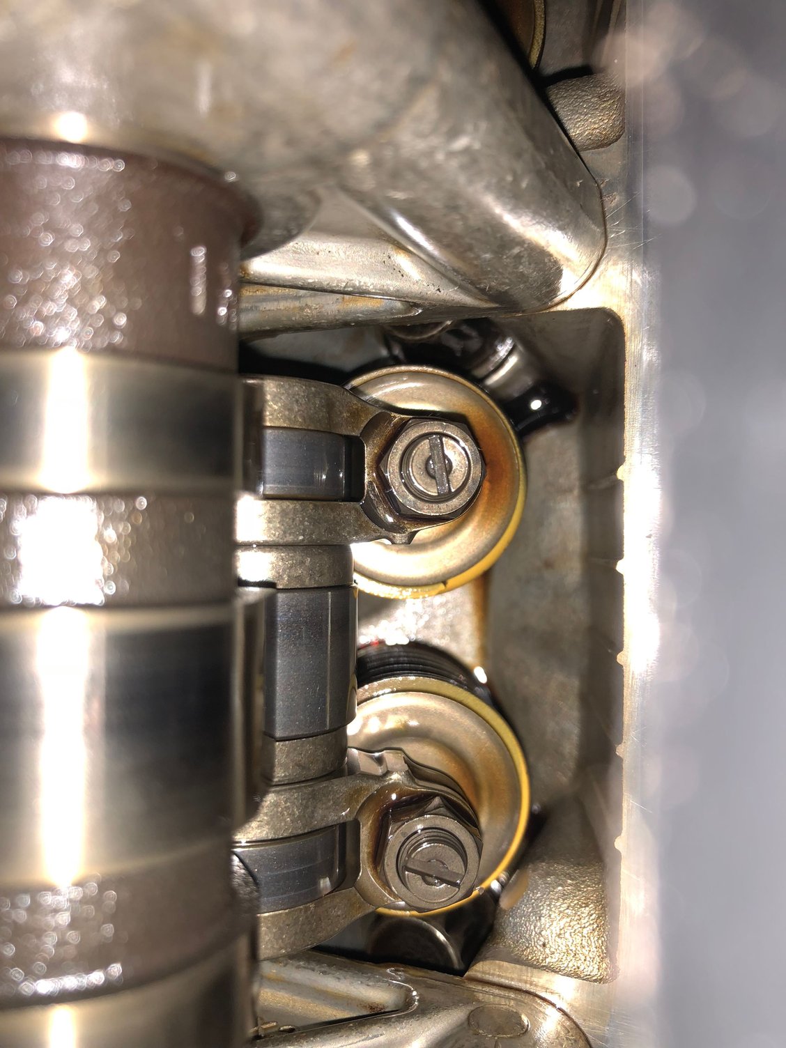

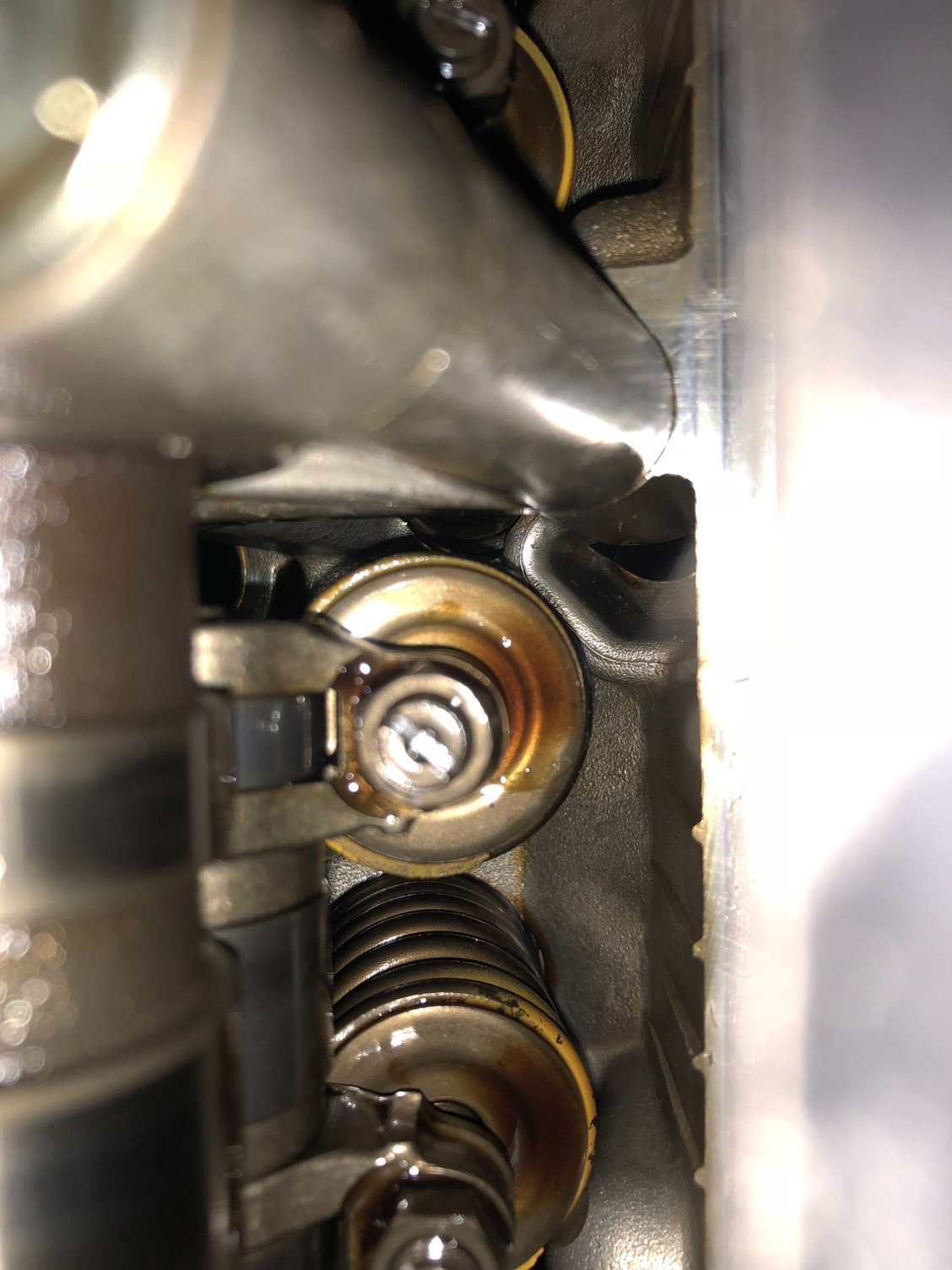

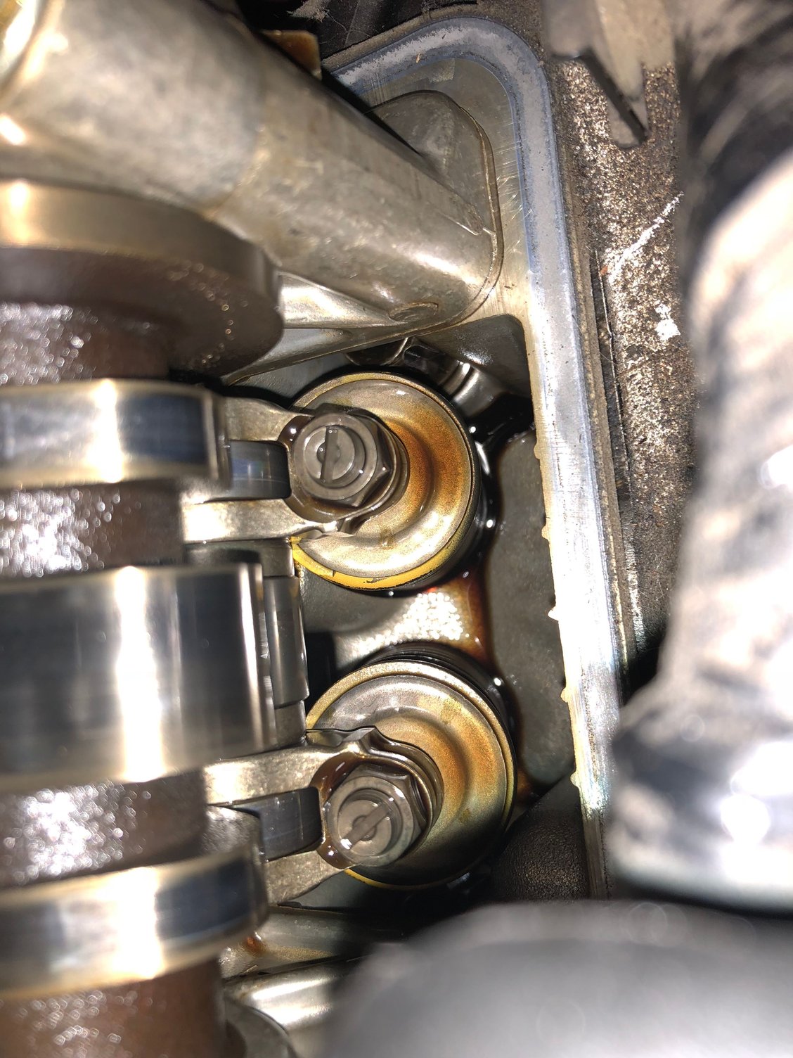

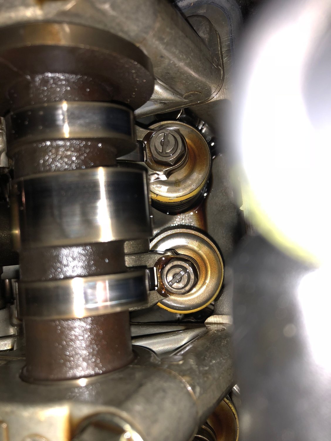

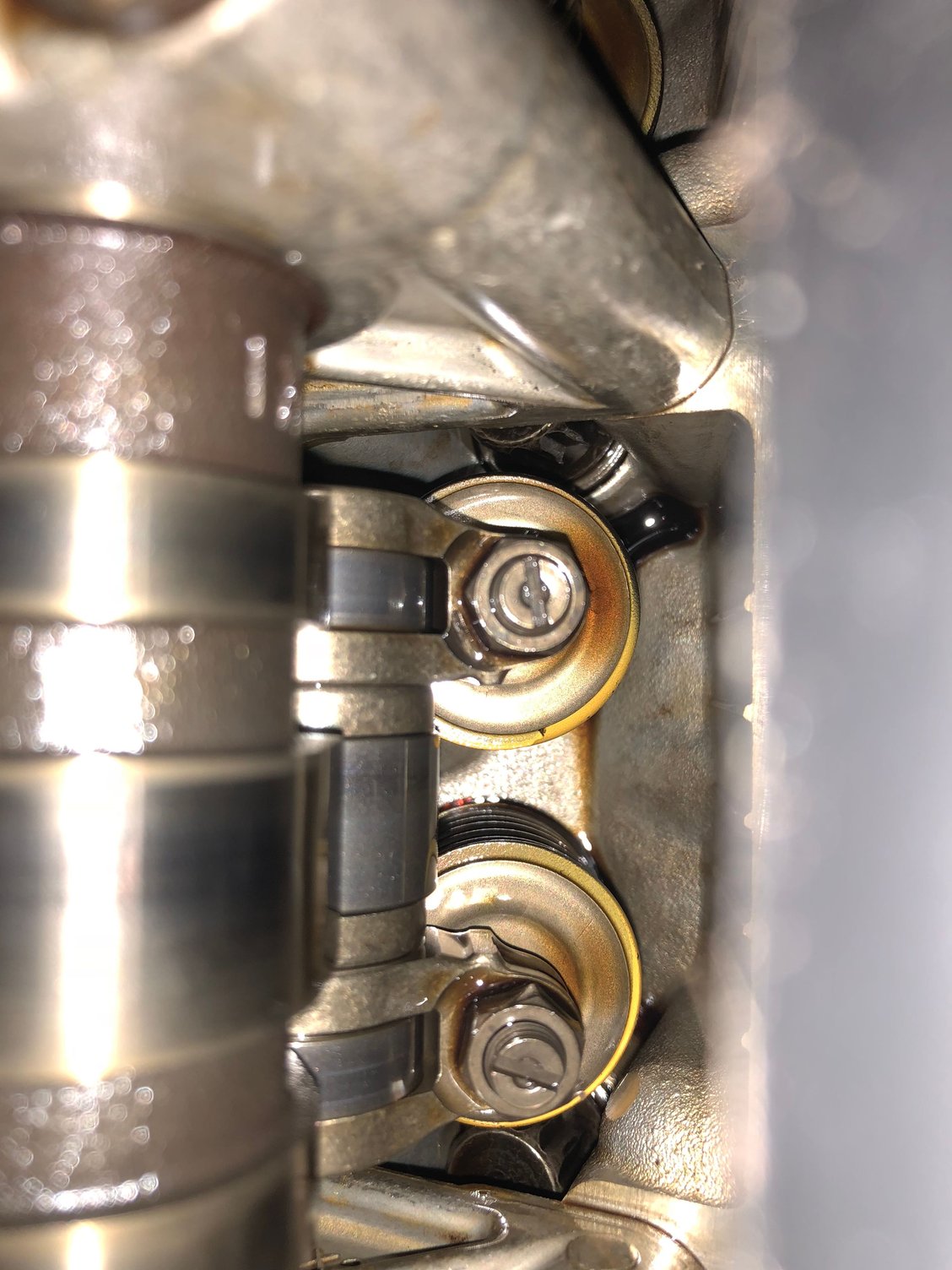

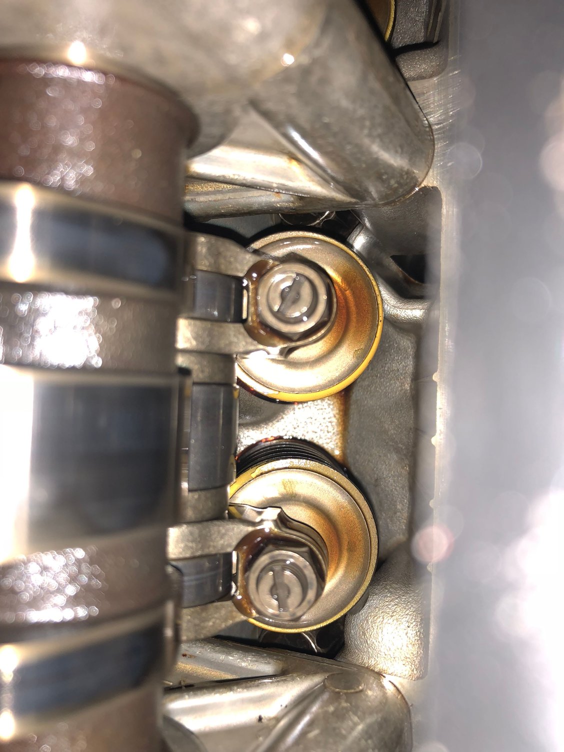

Sorry guys I didn’t wanna dig this up but at the same time I didn’t want to start a new thread, as soon as I seen “post it up” on the first page I was sold. Here are my intake valves. Tried comparing to others but I don’t see what I’m looking for

None of those pics are useable. They do not show the keepers (you can see one keeper in the last pic, but cannot see their position relative to the inner retainer wall)
