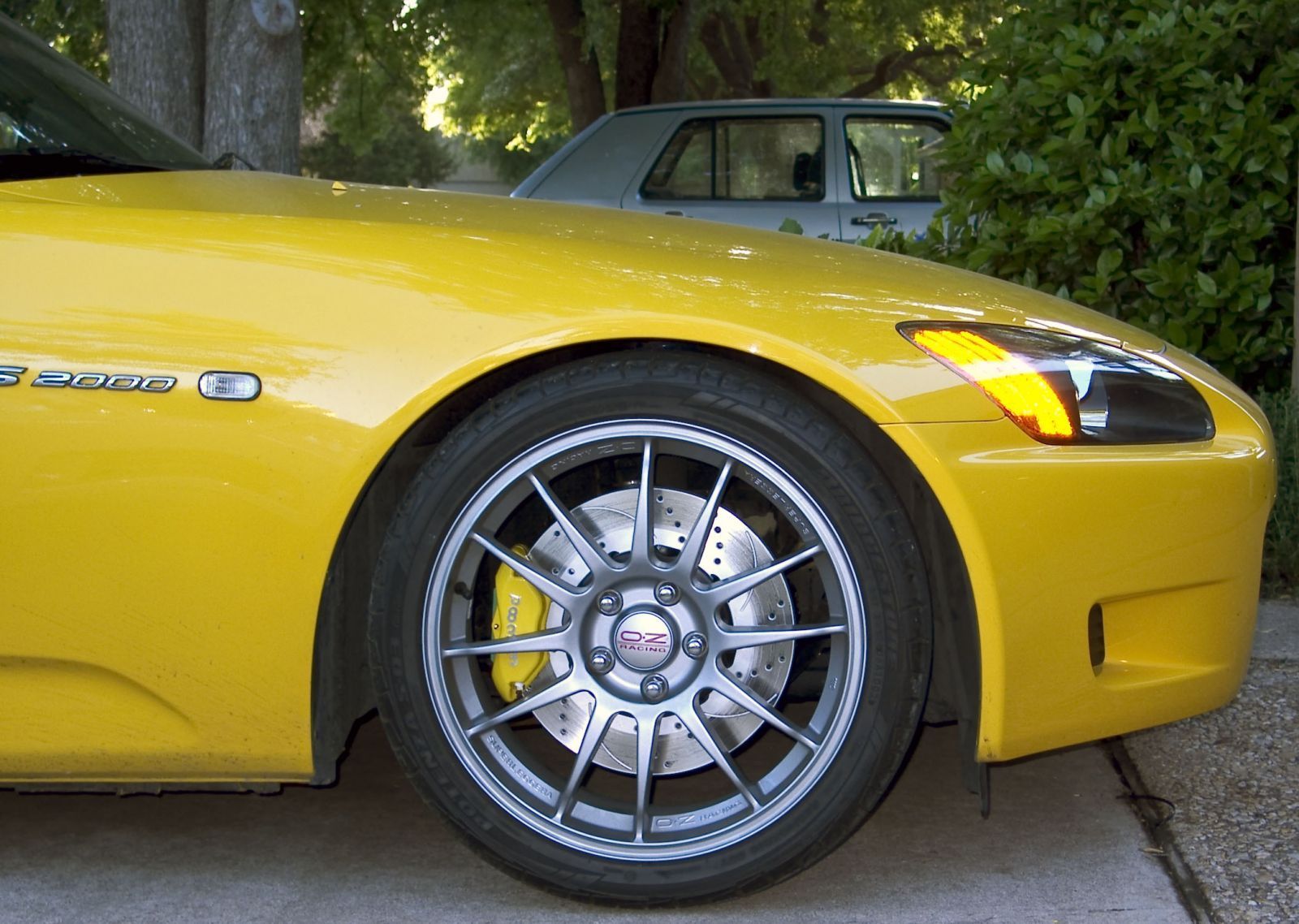

Wilwood has been around for a hell of a long time and has awesome products that work. I have the Wilwood kit from Docofmind / Team Spugen and on the street you'll notice the weight loss before you notice improved stopping distances. On the track you will notice a difference--but only until the lack of cooling starts affecting performance.
For the street the advantages of going with the Wilwood setup are:
Lighter weight (30 lbs less w/the Dynalite calipers)
Super easy pad swap
Trick look
Cheaper pads
For the track:
Lighter weight
Super easy pad swap
Less fade than stock (resulting in shorter stopping distances)
The biggest bang for the buck upgrade I think you could make to the brakes would be cooling--NASA Ducts and tubing or C&T Engineering Kit.
