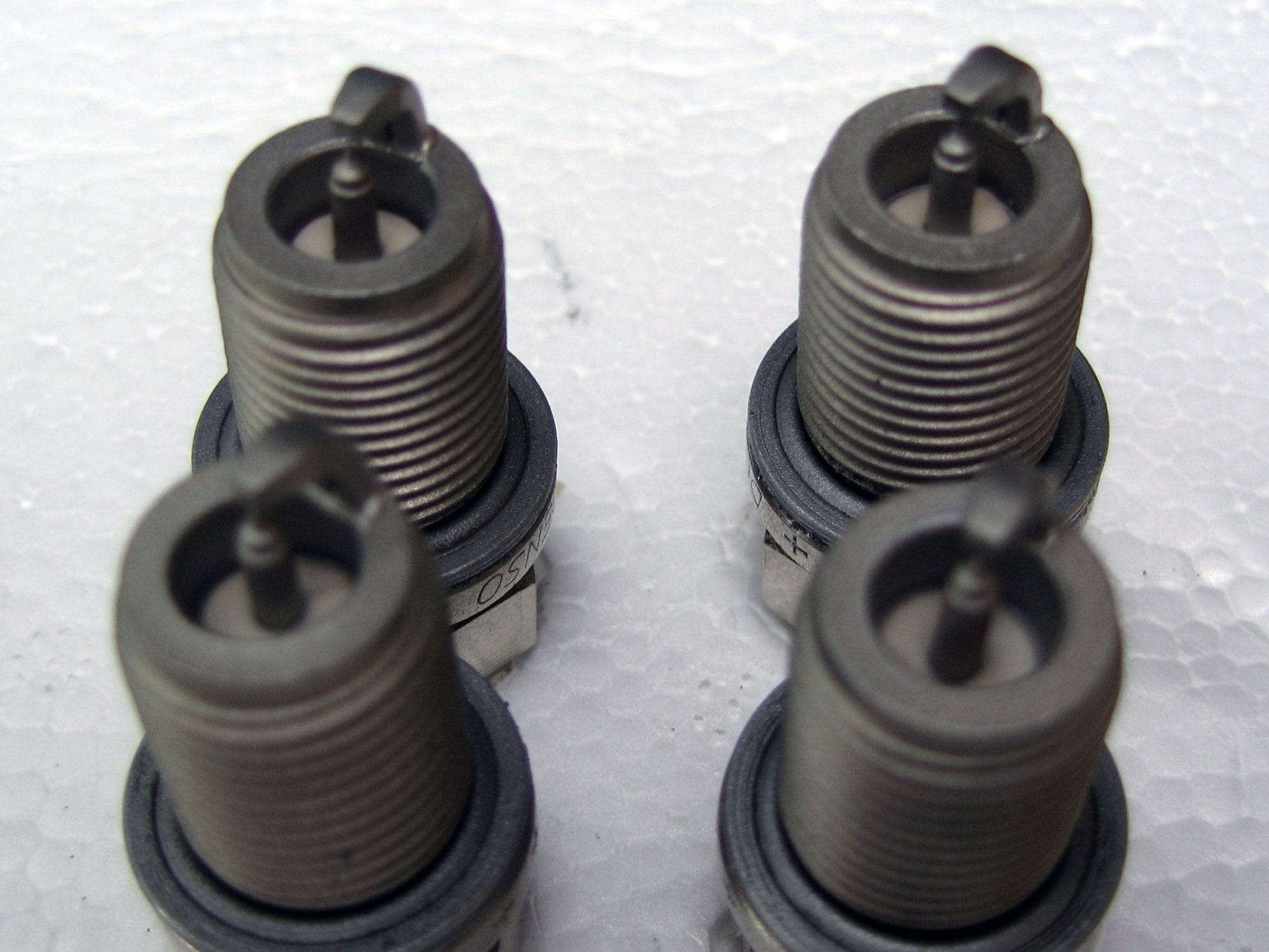

I'll try and take some close up pics of mine, cause same thing happend to me, except on all four. I think there might be a bad batch of Iridium plugs out there where the ceramic insulators were not properly sintered. The insulator appears to have turned to dust.

Well, here is a picture of my four plugs. I pulled them after the dyno runs and this is what I found.
There was absolutely no sign of detonation during the dyno run. And the datalog of the knock sensor confirmed this. I replaced the plugs with copper core ones and the car is running fine. I have never seen insulators disappear like this. I can only assume that there is a batch of defective Denso plugs out there. I'll pull the head and check out the internals, but only after I get my spare block and head built, and that won't be for another 8 to 10 weeks.

Car still runs fine. I Boroscoped the pistons and could see nothing abnormal. Anyone else have this problem with Denso plugs?
