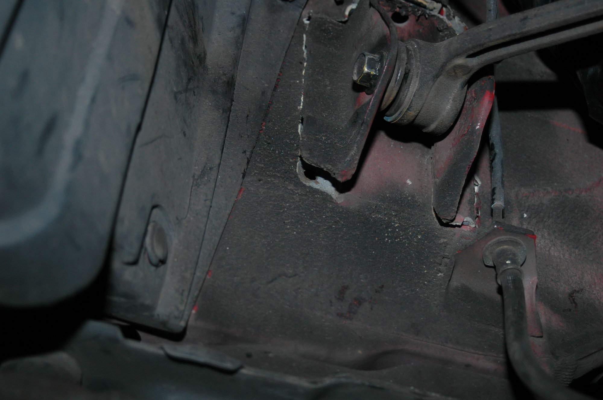

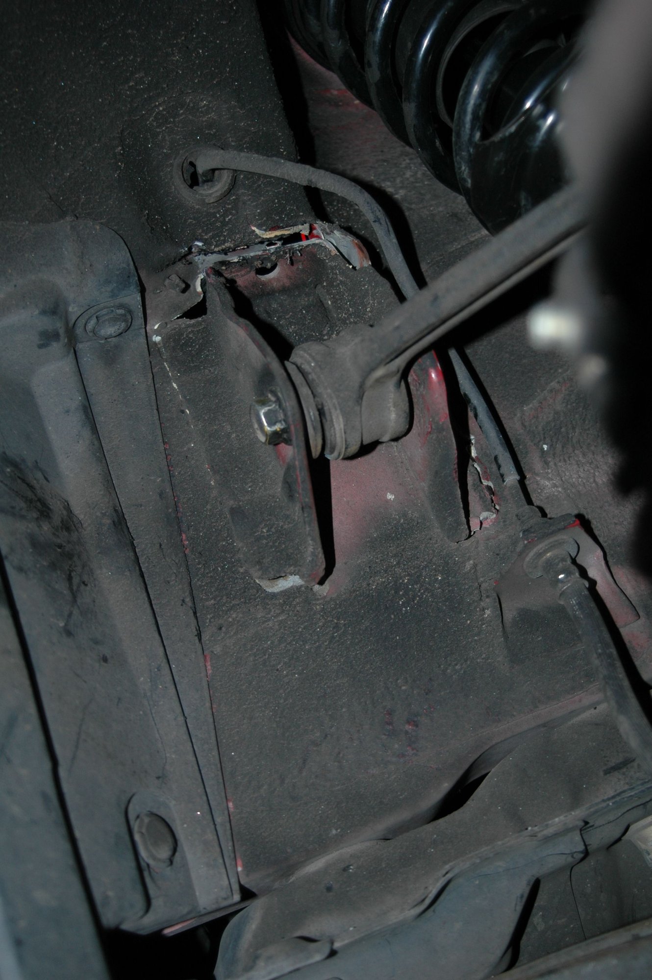

I have just Broken my Upper A-arm Mounting Bracket. I believe that there is a TSB for this. Does anyone know where I can find it? I looked in the S2ki TSB list, but found nothing. Any help on this matter would be appreciated.

There isn't a TSB; there was a letter composed by Honda in order to allow these to be fixed by seam welding the bracket and still permit the repair in stock class SCCA autocross.
The fix is take it to a shop and have it welded. Nothing more.

there's no TSB. some members have renforced it by welding where the cracks would form

Can i ask how that happened??

I think the theory is repeated hard braking from years of auto-x/track.
Yep.
