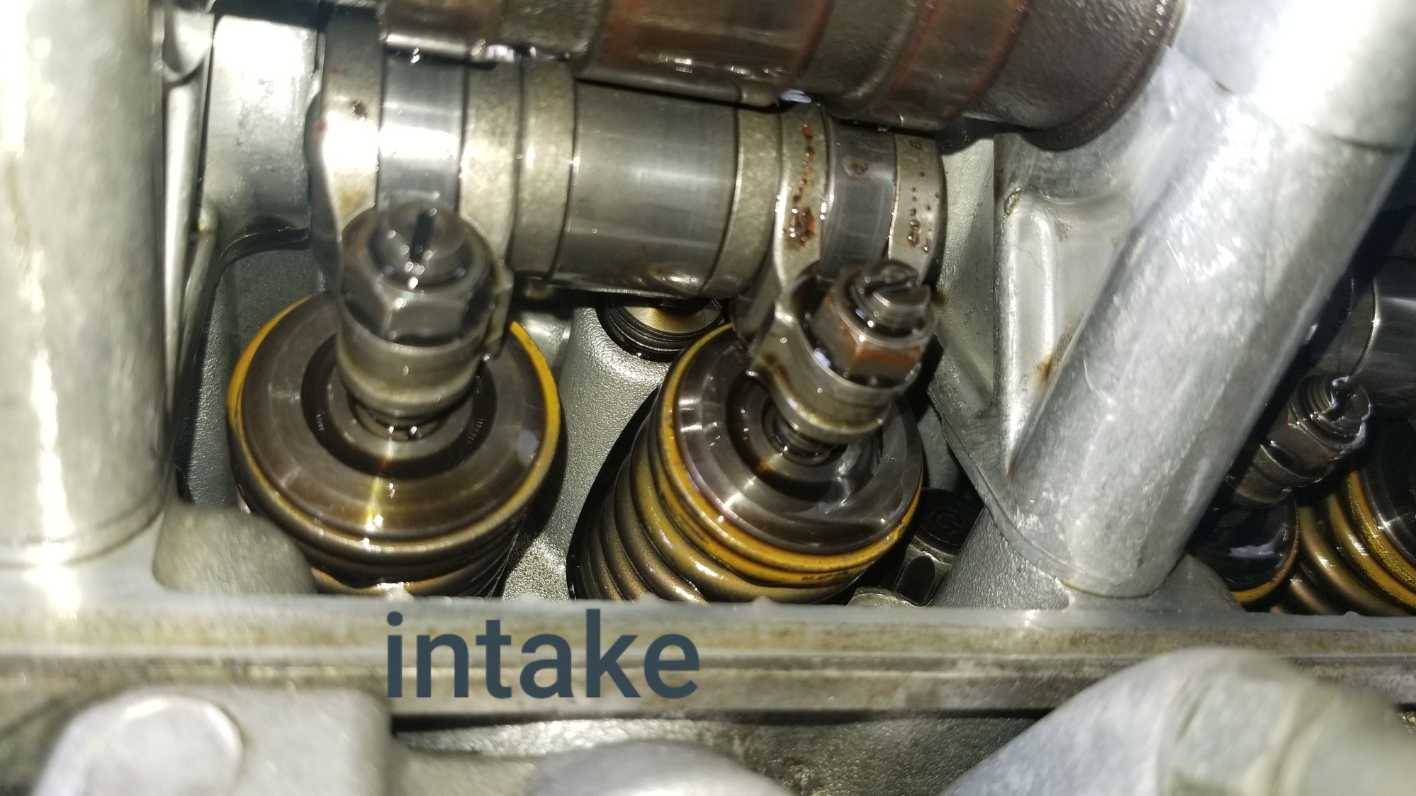

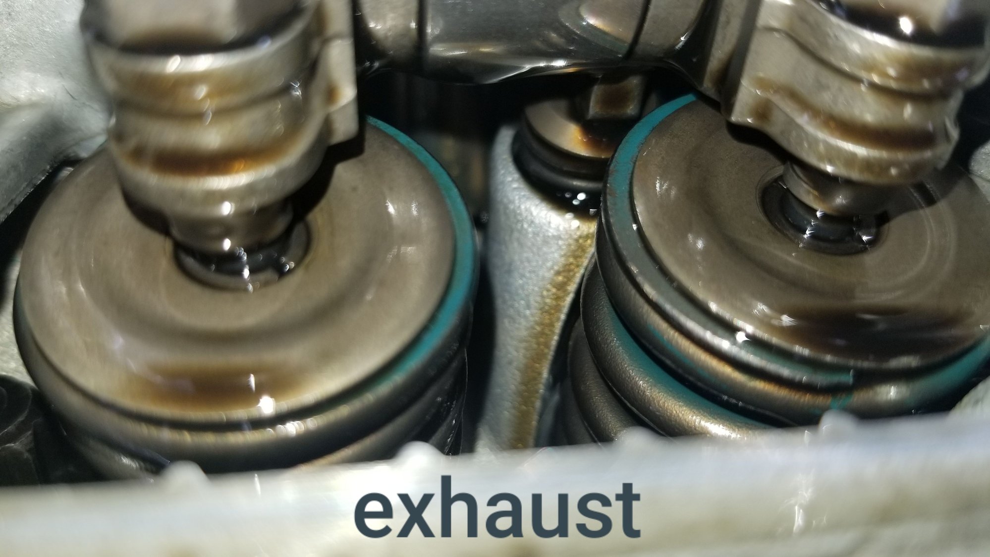

Bought a new s2000, ap1 with 72k miles. Its turbocharged, and has some other aftermarket parts. I even found round cylinders added to the dust shields to add brake cooling. Im thinking someone HAD to have been knowledgeable enough at some point to change to AP2 retainers....
even if i just take 1 apart, and inspect it.. any solid way to tell?
any help is appreciated.

I took pictures, im 99.9 positive it's does have ap2 retainers, can anyone verify?
thanks

Intakes are aftermarket titanium.
Exhausts are oem, tough to tell which ones.
billman thanks, yeah those sharp valleys in the intake side... know they wernt ap1....
