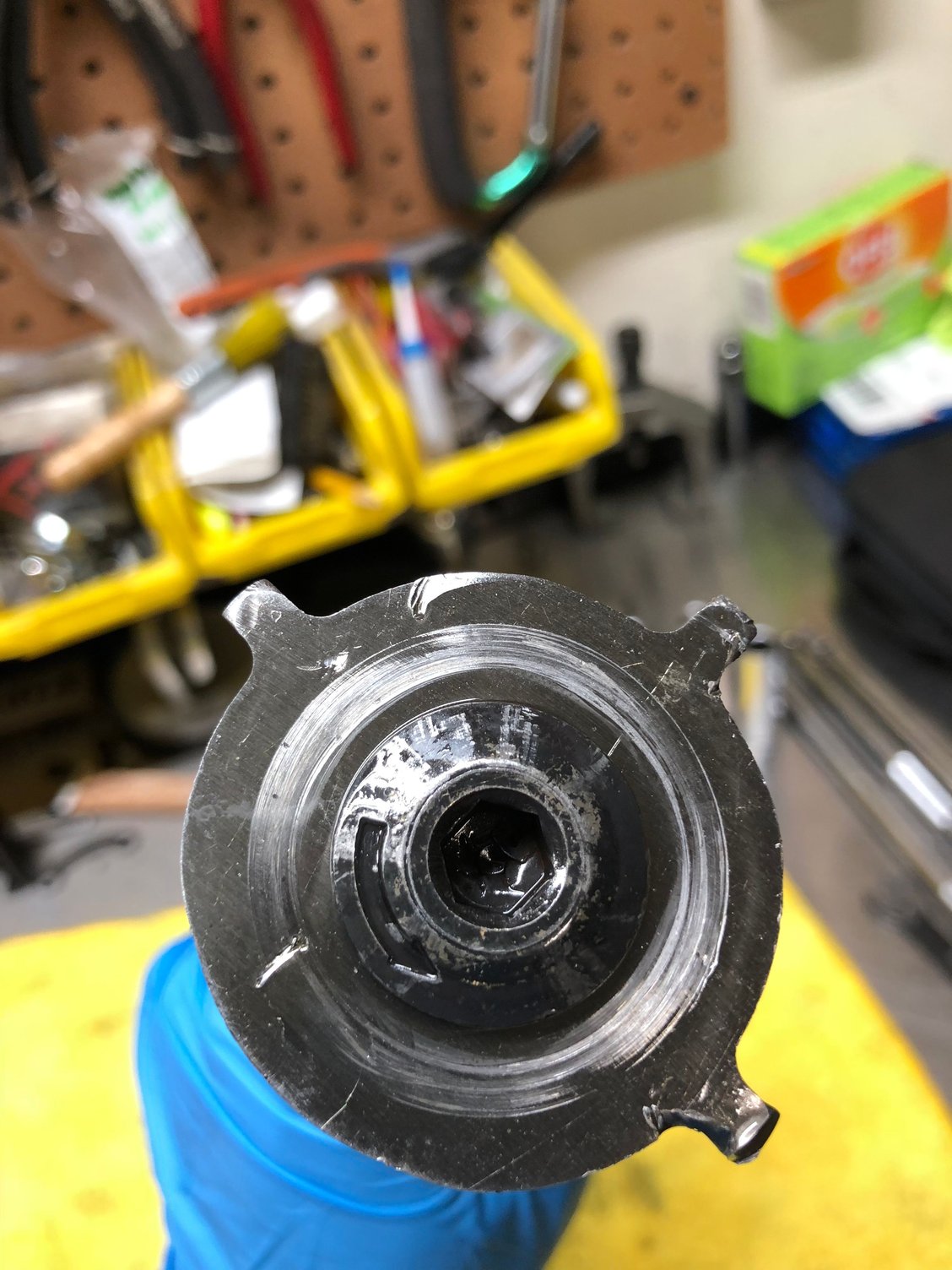

I tried some starter fluid, to see if maybe my E85 was bad, did nothing. Decided to take the VC off again and take the cams out, and my trigger disk on the back of the intake cam looked really bad. All the teeth are bent and a chunk is missing from one. I'm guessing the nut caused this?
Think that is enough to prevent it from starting? Going to order a new trigger disk and see what happens....

That could very well the the problem.
Be advised, that bolt i on pretty tight and is reverse threaded, use high quality allen key so you wont strip it.

Seems pretty reasonable to me, especially since the TDC sensors use those wheels for timing.
