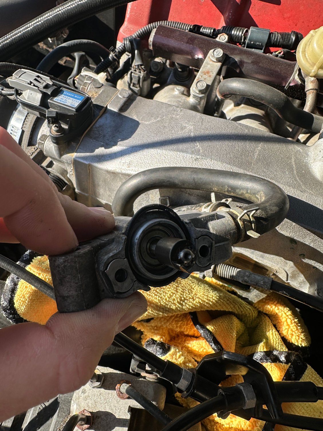

Initially talking to billman(don’t want to keep bothering him over the issue so I’m coming to the forums for some more help), he thought it could be the iac valve so I took it apart and it spins freely, but a oring was very stretched so I replaced it. Since then my idle has been great and after a rev it goes right to 1k and holds. Car drove fine sat-tuesday.

here’s a link to what the car is doing(took this last week before iac but same thing happened yesterday), like I said 99% of the time it starts up and idles like a charm and drives no problem, even after I have this issue on start up it drives perfectly fine. Issue started happening and so far has only happened leaving the gym and starting last week(the week after getting my car checked out by billman… of course lol) also attached is how much the iac o ring stretched and the new fitted one. Will upload video of how the revs sound now after the valve refresh
When I took iac
