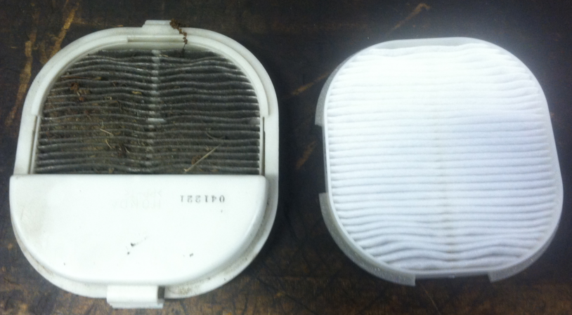

Recently bought an S2k and replaced both engine and cabin filters. The 5mm socket worked great! Thanks!
I bought an ATP Automotive HA-7 Carbon Activated Premium Cabin Air Filter from Amazon ~$16.
I'm pretty sure the old filter had NEVER been changed. Check it out:
