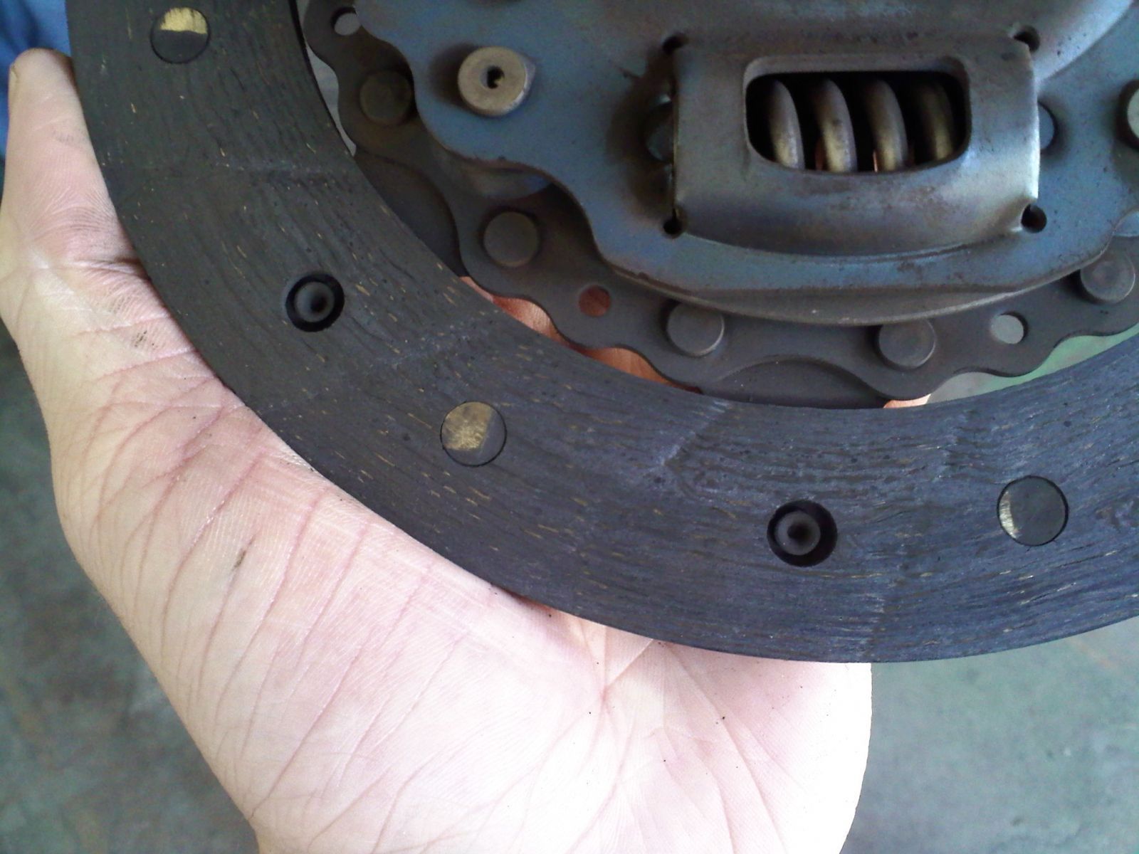

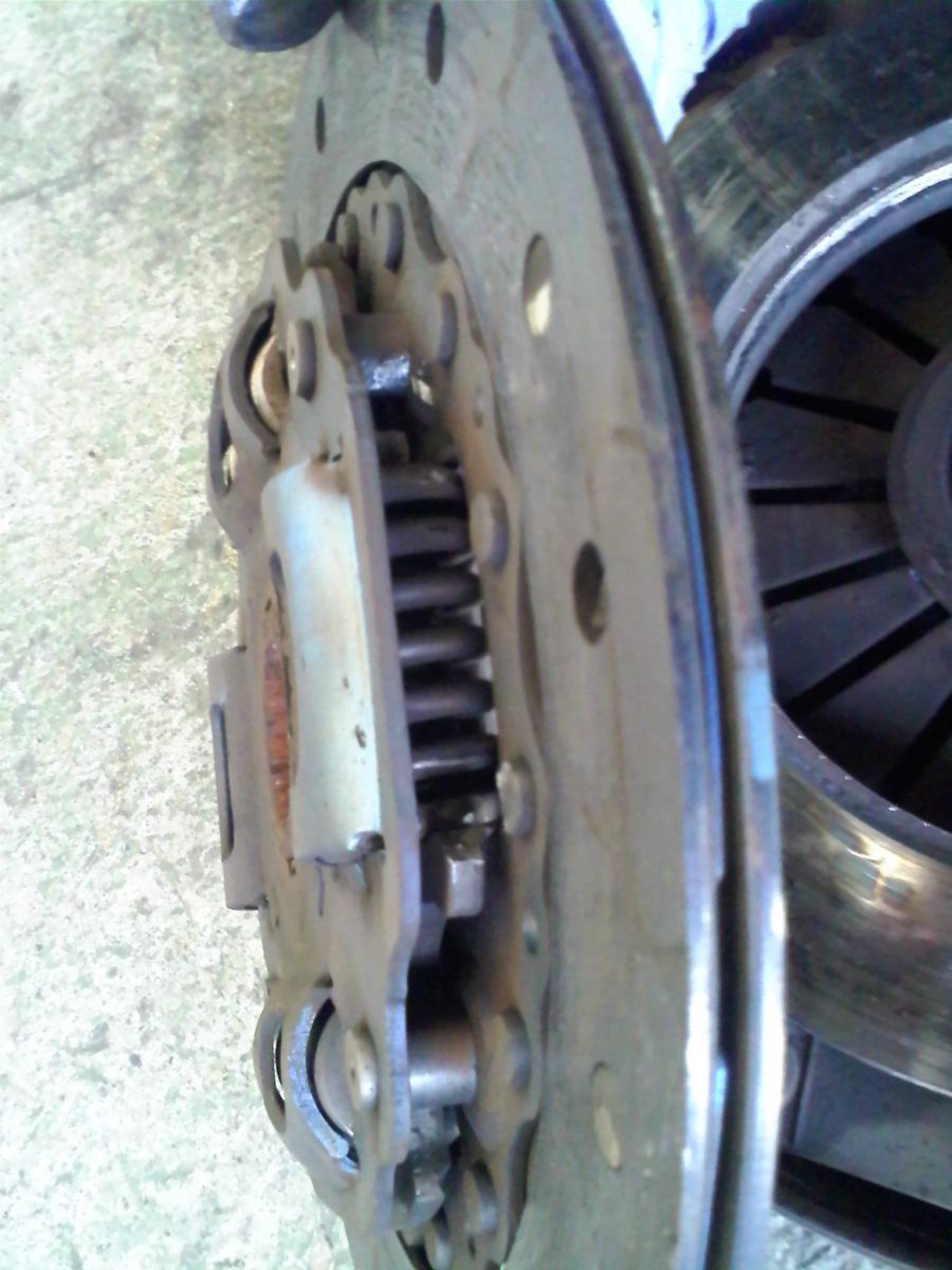

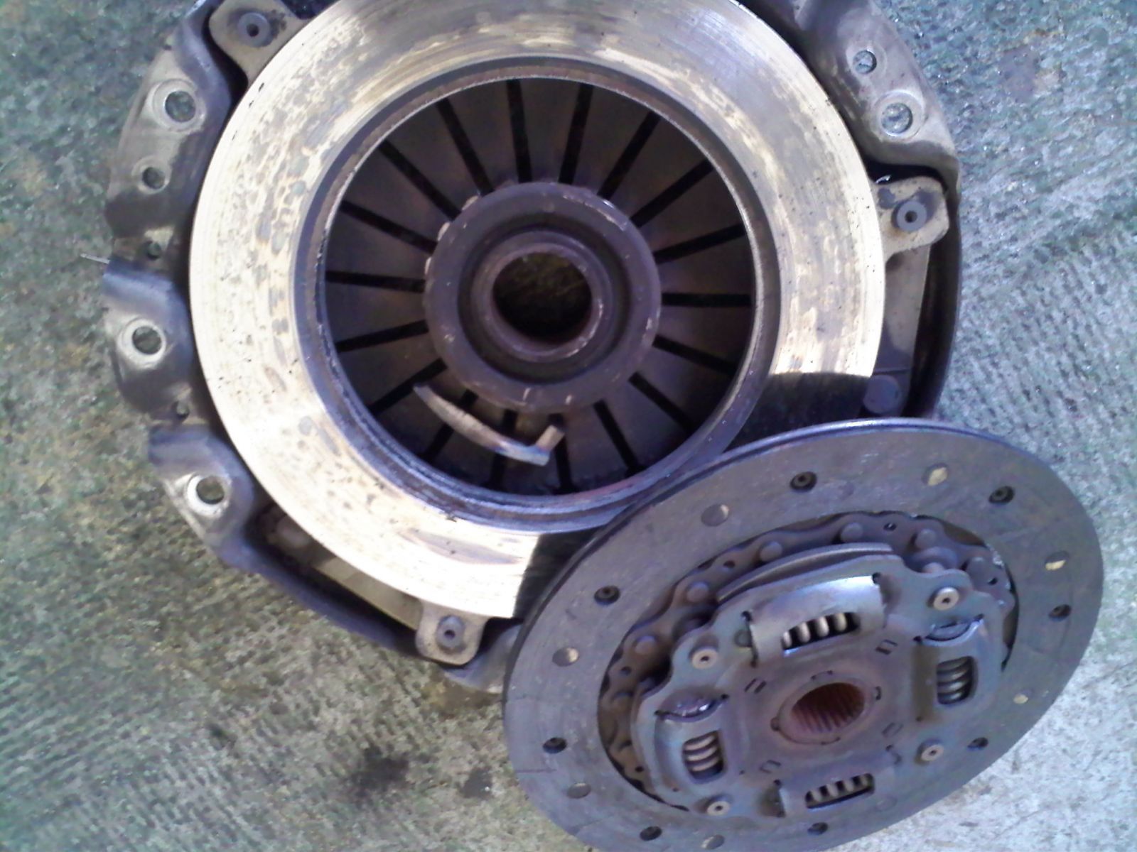

well, i had my clutch replaced on friday. the guys at the shop were all really cool, i watched the whole process. took the guy about 5 hours on a lift. he was a pro. i'm glad i didn't attempt this myself on jack stands.
anyway, looks like i got every bit of life out of my disc :
my clutch wasn't fully disengaging, and we quickly found out why.
there's a piece of metal surrounding the springs on their edge that looks like this:
it's a real problem when it looks like this:
basically, that piece had broken off and was lodged on the inner rim of the pressure plate. this was keeping a bit of pressure on the friction disc at all times, and keeping it up against the flywheel, thus not letting it disengage completely.
also, the slave cylinder rod was rough, and had a nipple on it worse than this:
we ground that smooth.
i'm happy to report that my car feels brand new now, and i've fallen in love with it all over again
