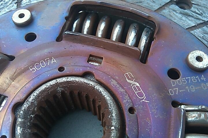

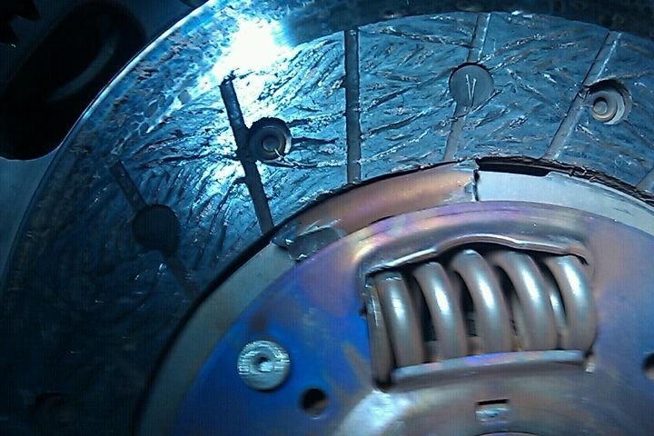

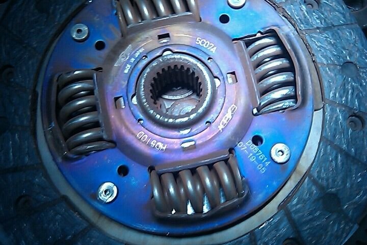

Well this was unexpected:
The spring tore the mount apart and lodged itself in one of the holes in my prolite flywheel. The pisser is that it still has .310 of material which is only .005 under the brand new thickness. I've run it at least 60k, but I don't understand this failure. I remember now that I ordered a HDSS setup from an ACT dealer and was a little irked that the disk was exedy. I would have rather an OEM disk.

There are pics on s2ki of OEM disks with simular damage.
Lots of agressive clutch action in the past?
Old Nov 6, 2010 | 11:57 AM
SgtB's Avatar
Joined: Dec 2007
Posts: 3,947
Likes: 8
From: Raleigh, NC
Lots would be an understatement. The oem disk I have looks more substantial, but I guess enough shock loading will break anything. Oh well. Another ornament for the wall of carnage. Happily it didn't ruin anything else.
