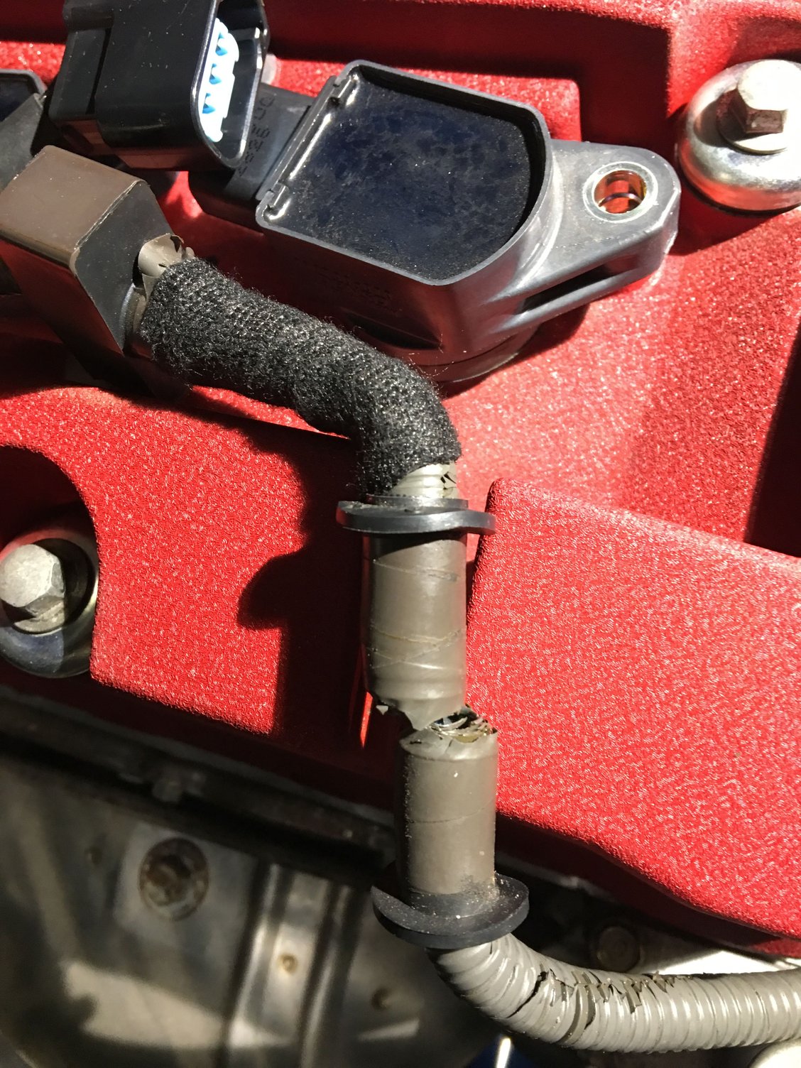

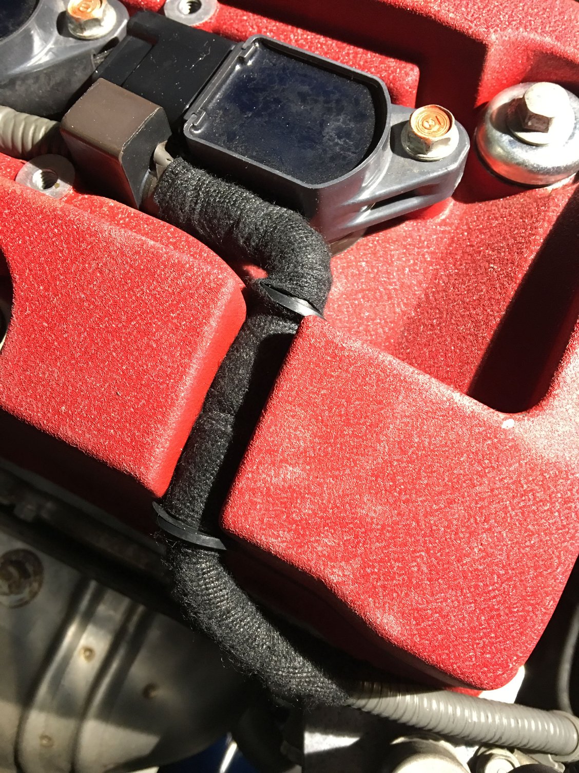

I recently replaced my spark plugs on my 85K 2005 and pulled out the Denso plugs, are Denso plugs original on this car? Anyways all clips broke mainly because I also wanted to adjust the valves and needed the engine cold to properly adjust the valves. Ordered the new clips but I also have problems with wire looms shattering and now can see some wires exposed. Do we have any recommendations on wire looms we can use to protect the wires? Was thinking of just using self sealing silicone tape, but not sure if they will protect the wires from heat.
I used a Tesa adhesive cloth tape.

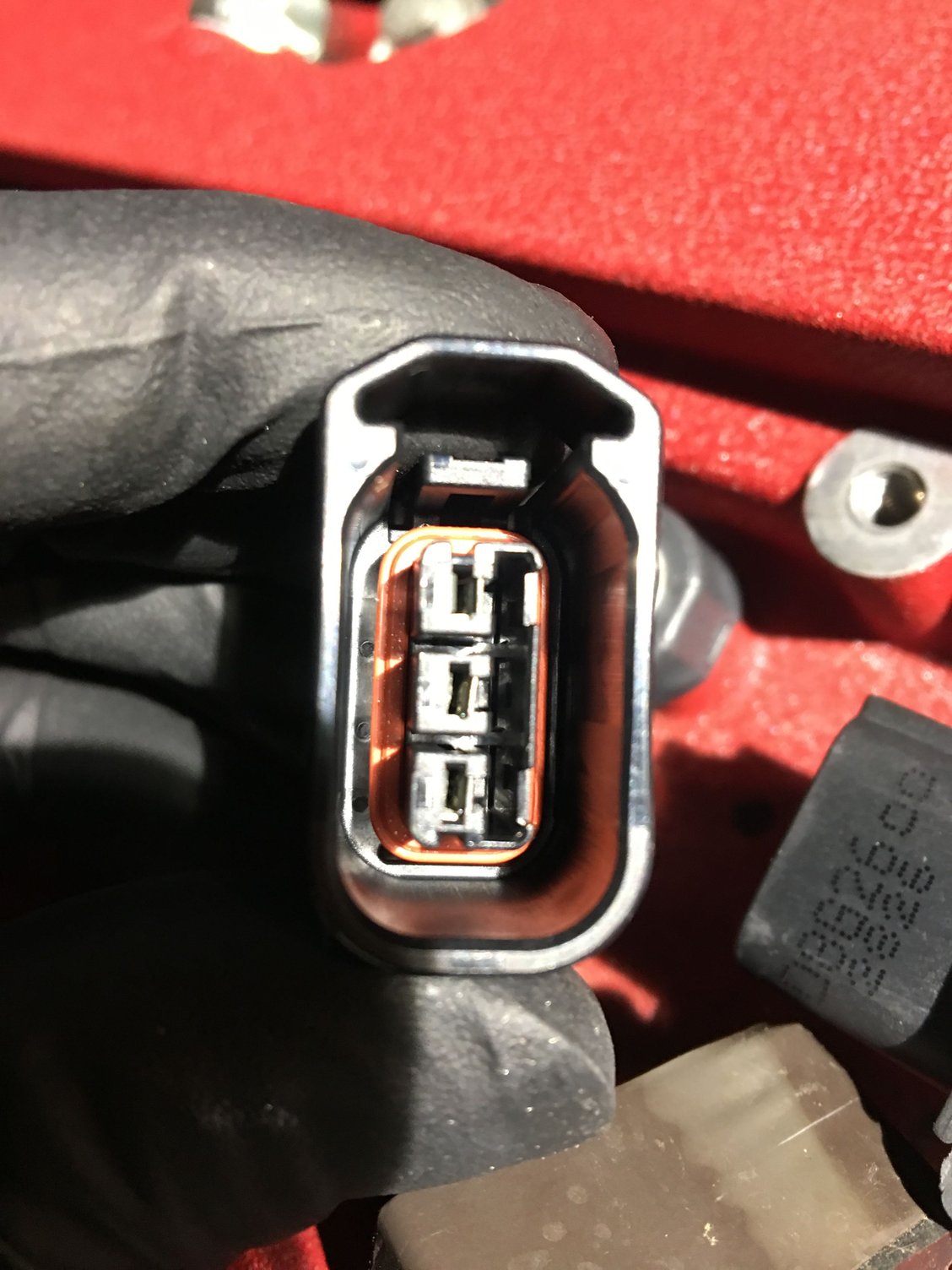

Thanks to this post and help from others, I managed to replace the locking connectors. It was a good thing as the housing was literally falling apart and they were no longer was usable as I pulled them out. The pins pulled out easily without having to release them from the housing. IMO, I think the aluminum plug cover is a bad design all it does is trap the heat and the plastic connectors suffers over time. There should have been some cooling vents on the cover.

Here is my repair pics, the parts I got from Cycleterminal looks original, they are perfect. As you can see the plastic was so brittle I kept pieces of it from falling into the spark plug holes by keeping the coils in place. If you have 70k+ miles I recommend replacing these connectors. I actually did 4 things while I had the valve cover off. 1 -adjusted the valves, 2 -replace the valve seals ,3- replace spark plugs, 4- replace these connectors.

Where did you get the cloth type stuff to wrap the loom that was falling apart?
Old Dec 5, 2019 | 07:32 AM
  #29
rockstar143's Avatar
Joined: Nov 2013
Posts: 868
Likes: 22
they have it on amazon.
it's what the Germans use.
Old Dec 5, 2019 | 07:52 AM
  #30
licelsior's Avatar
Joined: Jun 2016
Posts: 192
Likes: 24
Look up "tesa tape" and research the different part #'s for interior/exterior use.
