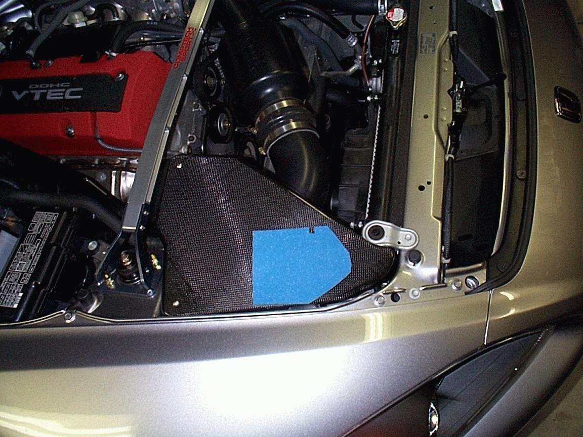

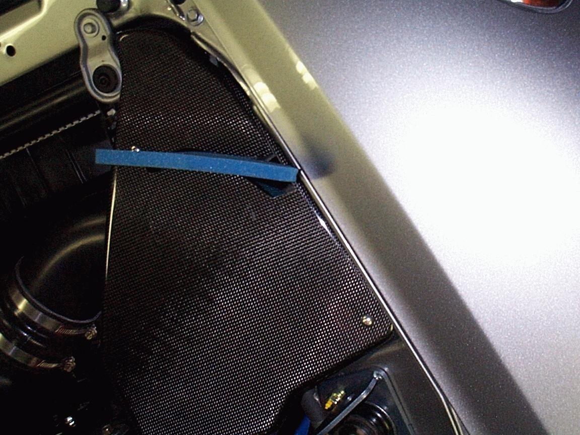

Here is what I did to solve the resonance problem.
I took a piece of high-density packing foam, the kind used in packing electronics. The piece was 3/8th of an inch thick and a 4 1/2 x 6 inch rectangle. I used it to cover the hole on the top of the air box where the support rod goes. This solved the problem !!!
Pic1 is of the completed install of the CAI. ( Sorry about the reflection from the florescent lights. )
Pic2 is with the piece of in place.
Pic3 shows the thickness of the foam.
This fix really works ! Plug the hole.

So if you cover the hole where the hood support rod goes....where does the hood support rod go?
-YS
-YS
The hood support goes where it always goes, no change there. After the rod is placed in the clip, cover the hole, then close the hood.
-YS
Thats why you put the hood rod in the hole first, then put the foam on, and last close the hood.
Thats why if you glue the extra pad to the heat pad on the hood you just do everything the way you always did.
