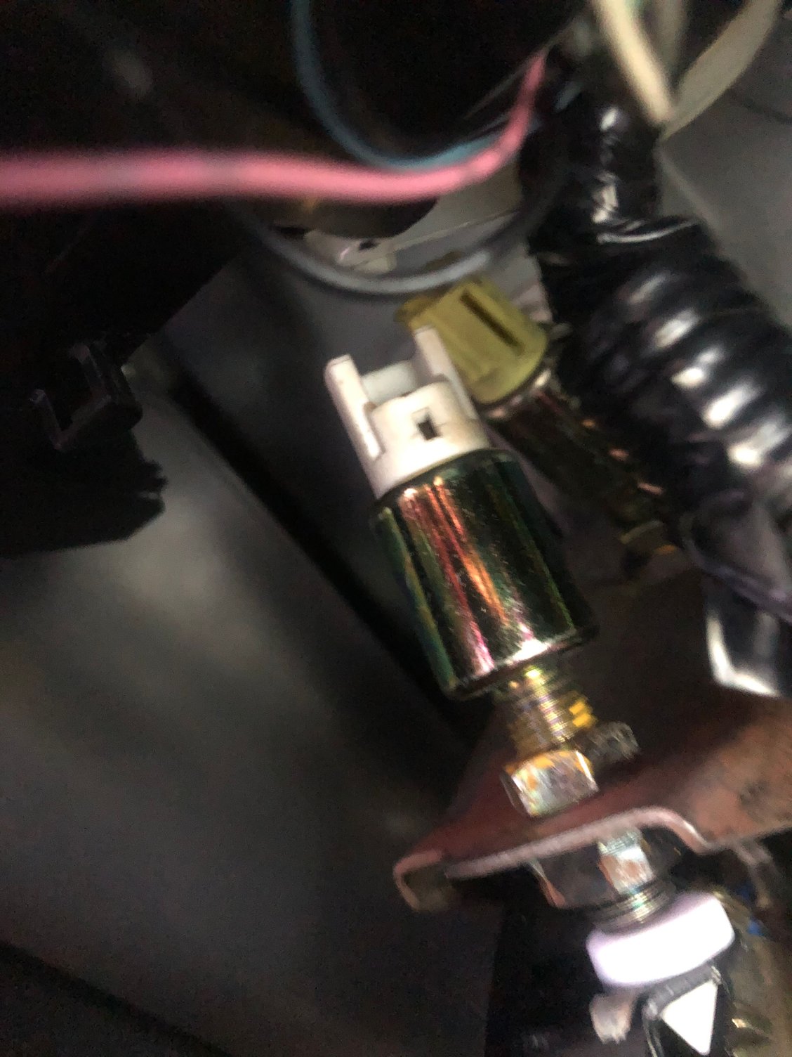

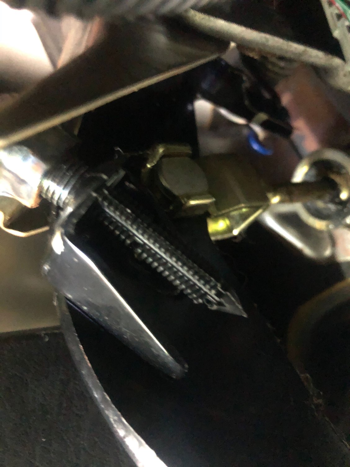

OK......I am not sure this is OEM.

Looks like the white button broke, and was replaced with the black plastic tree clip. Be sure it is pushing the button all the way in while at rest.

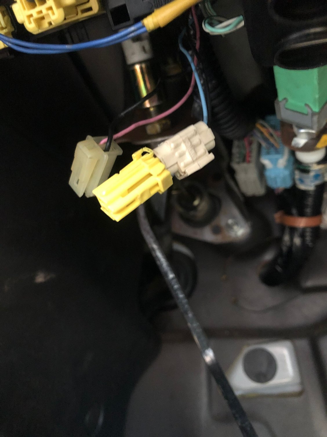

i did find 2 loose wires...see picture.
i assume they are just orphans and don’t go any where?????

There is no connection to the cruise control switch!!
any idea what color wire goes there???
