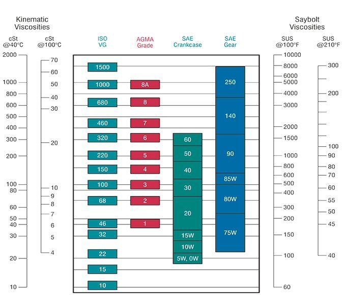

The new LE-1605 is indeed ISO-220 which is the same as SAE gear lube 90 (LE says it's SAE 110) so it meets the "90" requirement but not the GL5 requirement. The new LE-1605 is specifically not GL-5.
This is the new bottle:
The ISO viscosity measure is much tighter than the SAE. See the data linked below:
https://www.glennbennettcorp.com/hub...-Reference.pdf
Note how SAE 90 covers a very wide band of ISO grades ranging from ISO 150 to 320. SAE 110 doesn't show on the chart but is somewhere between 90 and 140. The chart shows the general cST measures making it especially helpful.
