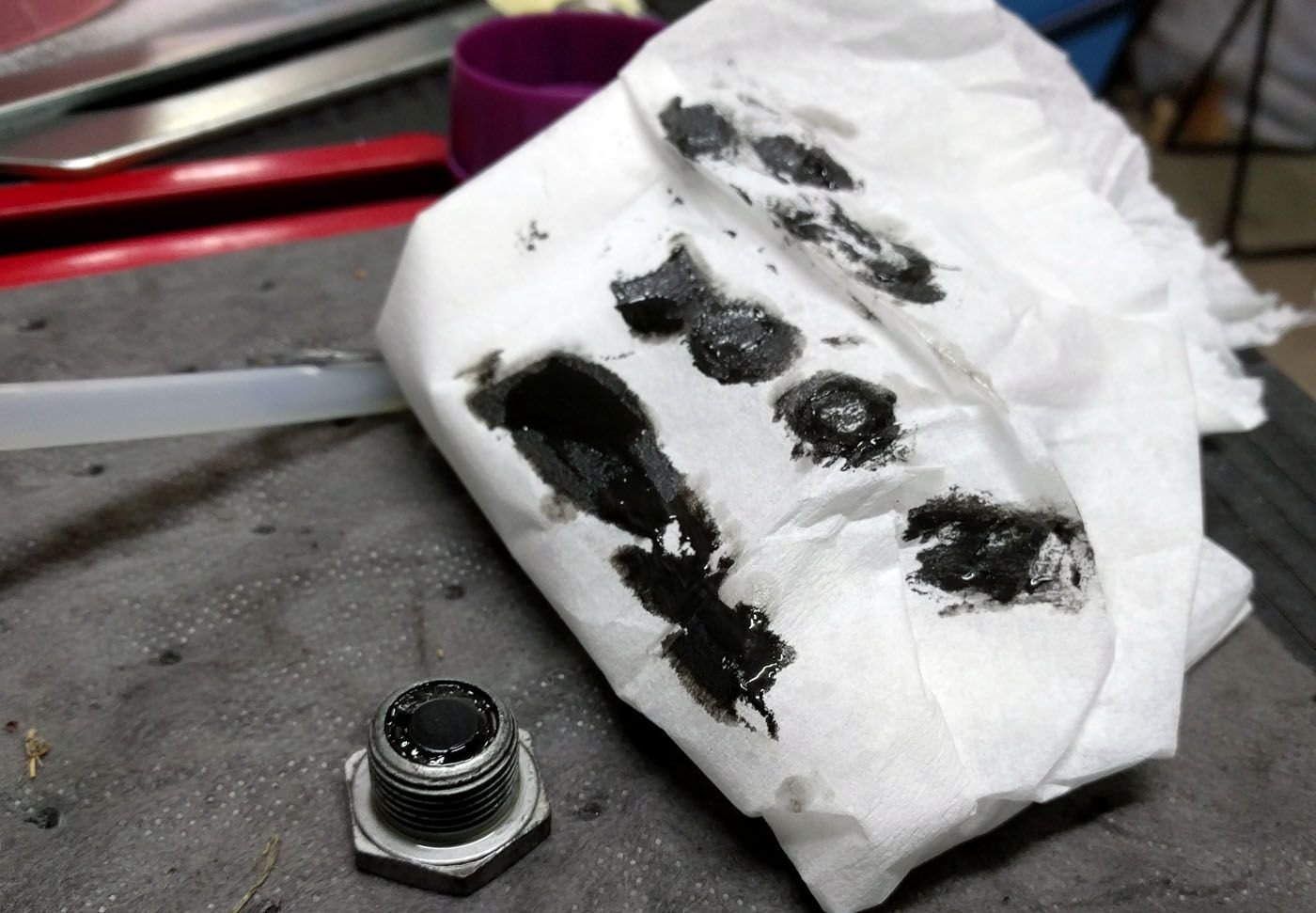

A couple of comparison pictures from the drain plug magnet.
This is from after one year of use, a few track days and maybe 1000 miles in total. Lucas synthetic 75W-90.
I have also tried the super expensive Honda SAE90 hypoid oil, that one I ran for two years and it came out similar looking to the one above.
This is one year of similar use with a 50/50 mix of the Castrol oils.
Scientific? Not really but it's enough for me to not try any diff water again
I will probably go for a straight 75W-140 on the next change.

To flanders: did you notice anything from the rear in handling / behaviour around tighter turns going to the 75W-110mix?
For me the change was back-to-back: notice weird behaviour for a while - go to dealer - change diff oil - drive away - weird behavior gone, instantly.
< me being a happy driver again.
Do those Castrol oils smell the same?
Or does the 75W-140, like the Motul, has a distinct 'rotten egg' sulphur smell and the 75W-90 does not?
The 75W-140 won't let you down

@flanders: Are those small metal bits on the drain plug in the first pic or just odd reflections of light?
