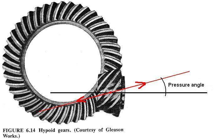

This is my 4.57 gear set.
Red is the ring center, green the pinion centerline.
The distance is the offset.
This is the (my own) OEM 4.10 gear mesh.
Imagine the pinion turning counter clockwise and how the pinion and ring teeth slide over eachother.
(Imagine a side washer 'ear' getting caught there!)
You're looking at the drive side of the pinion.
Hypoid gears create axial forces along the pressure angle on the pinion when it turns, so it's pushing against its conical bearings
That also means the pinion pushes the ring away, that's the load on the Torsen/ring bearing caps.
The higher the offset the more those forces are inline with the centerline (= good) but the more sliding between teeth (= hard on the gear oil: GL-6)

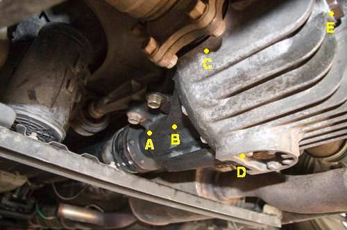

The oldest post of me on s2ki I can find via S2ki profile search is from 2013 and the temperature post was 2006/7 or so.
At the time I took temperature readings at the yellow dots with a Fluke and thermocouple.
I remember there was a little drop of oil on the drain or fill that acted like heat transfer oil and showed higher temps than just holding the sensor against the metal.
IIRC the temps were something like 60-70C or so after a spirited drive.
