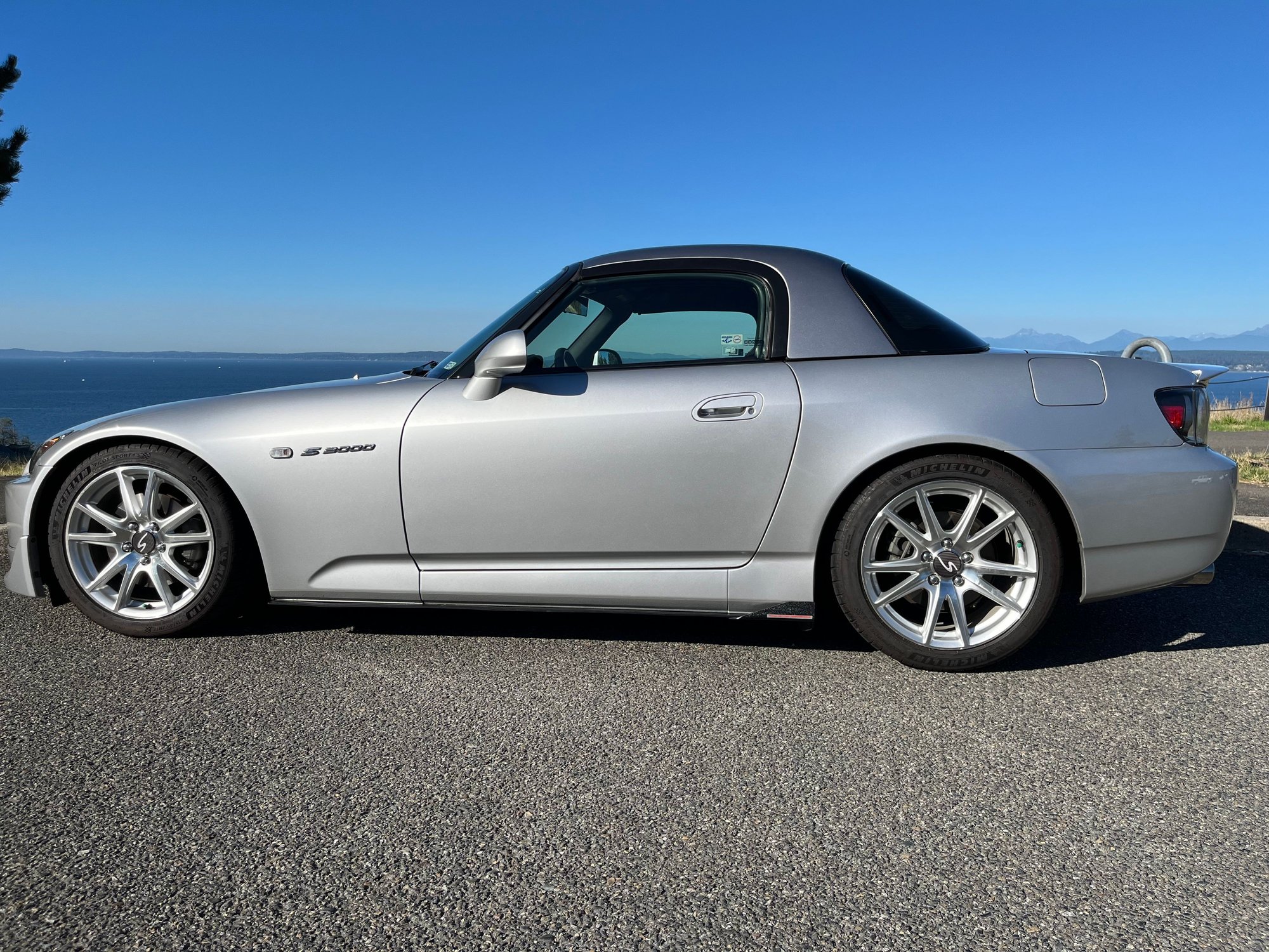

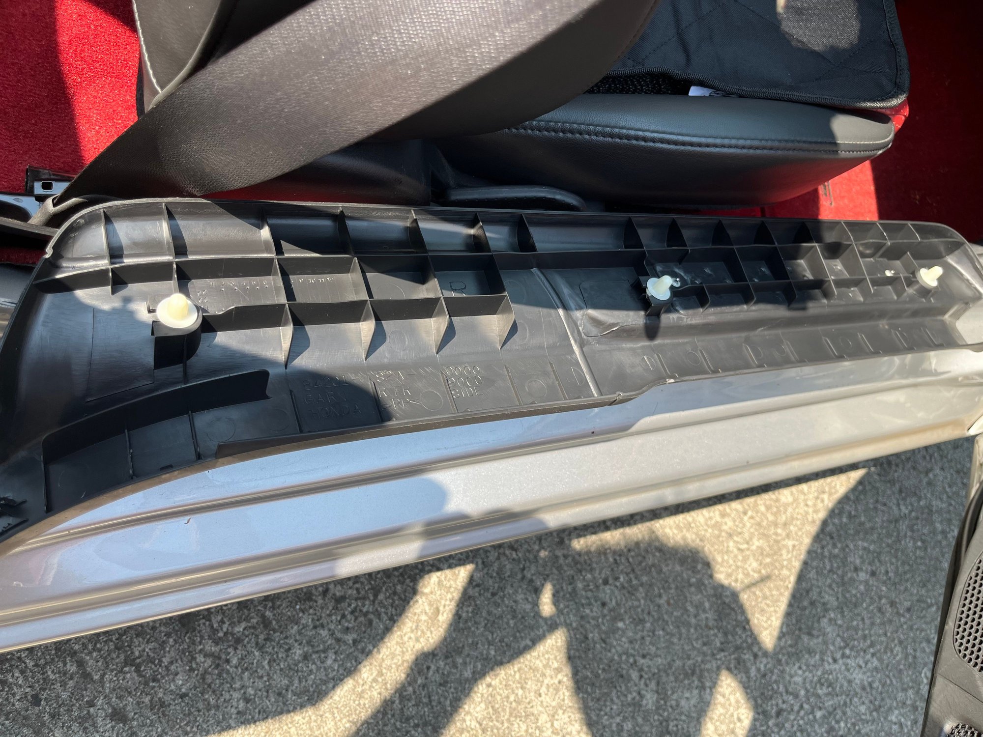

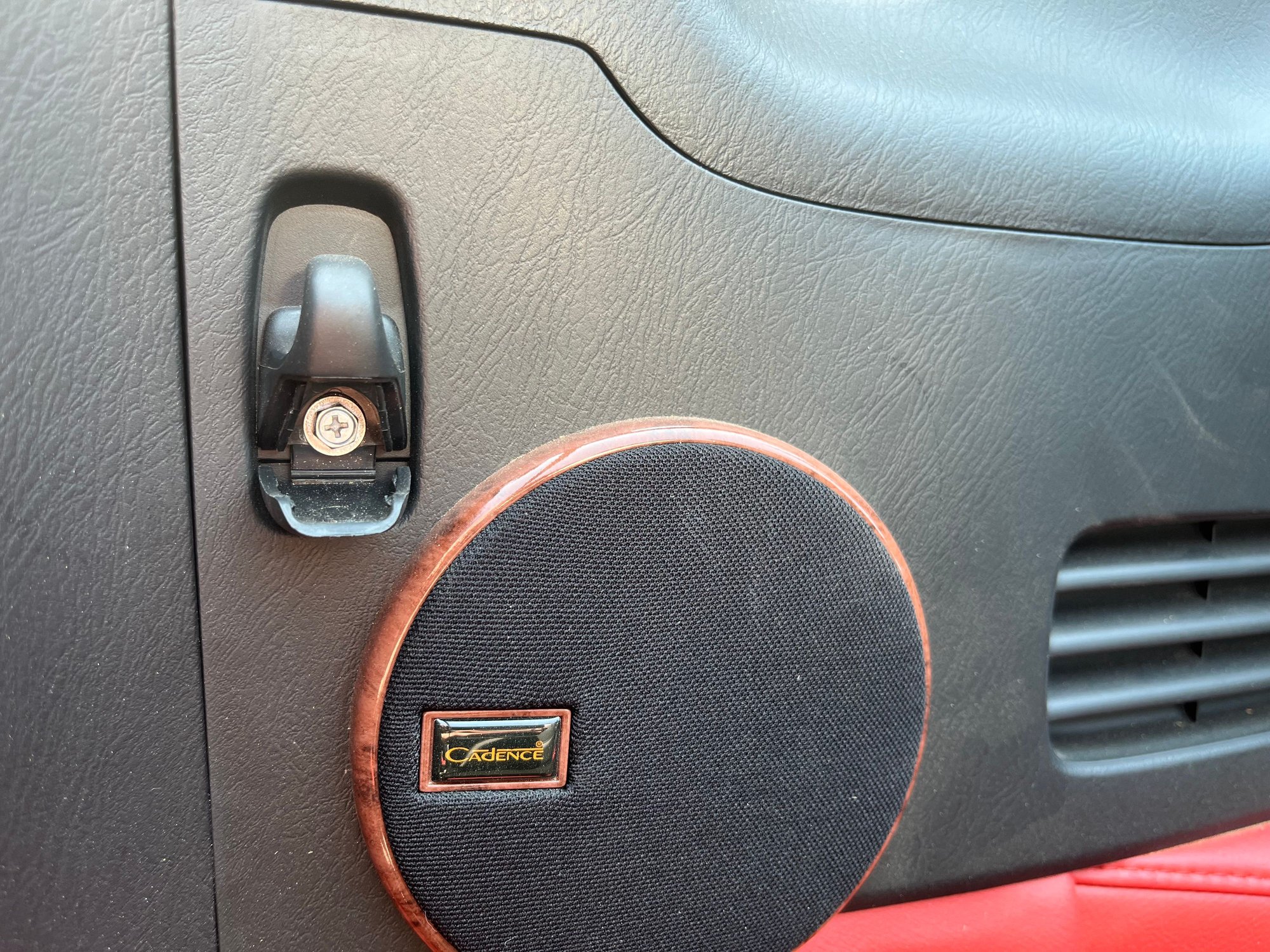

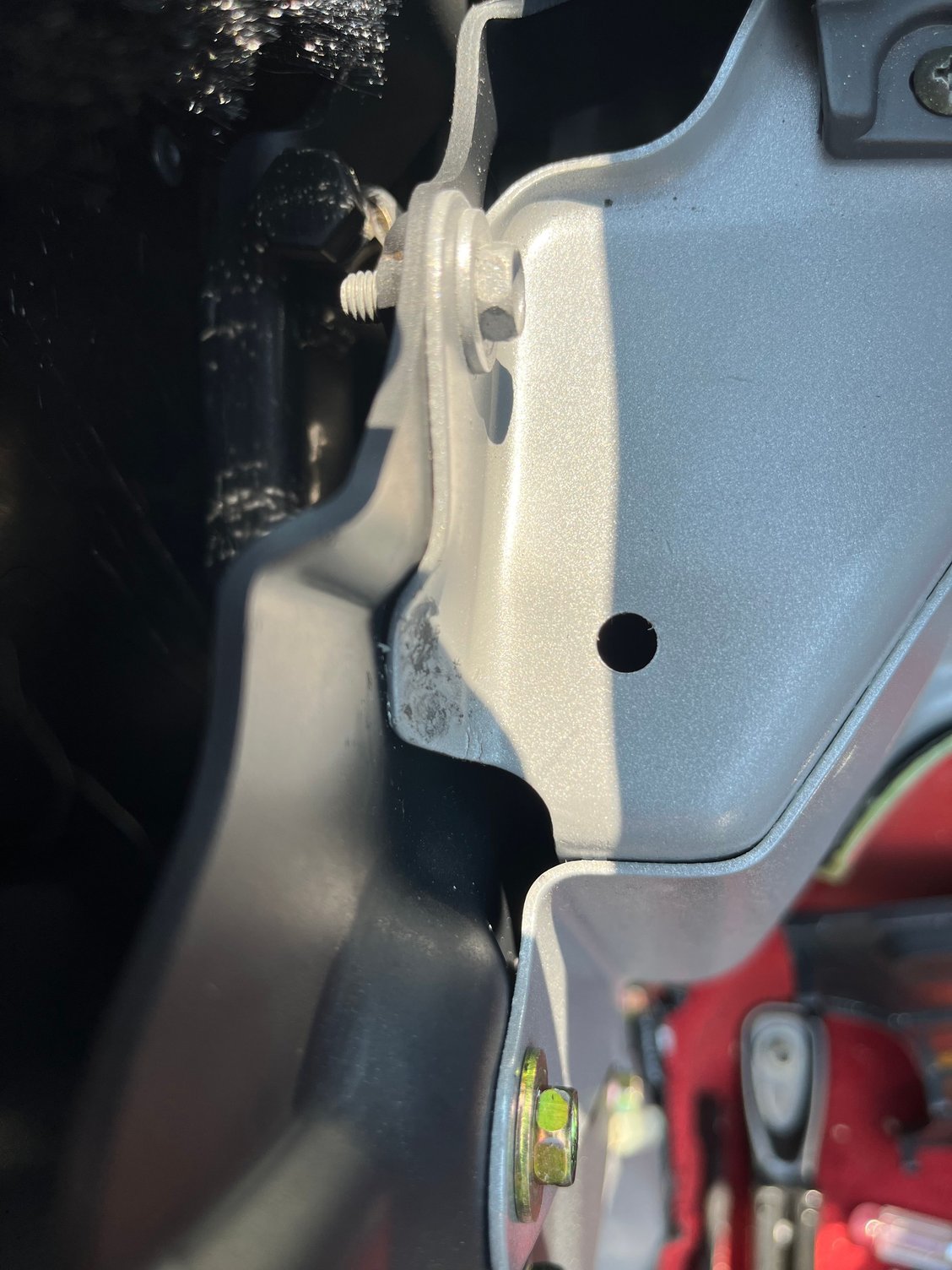

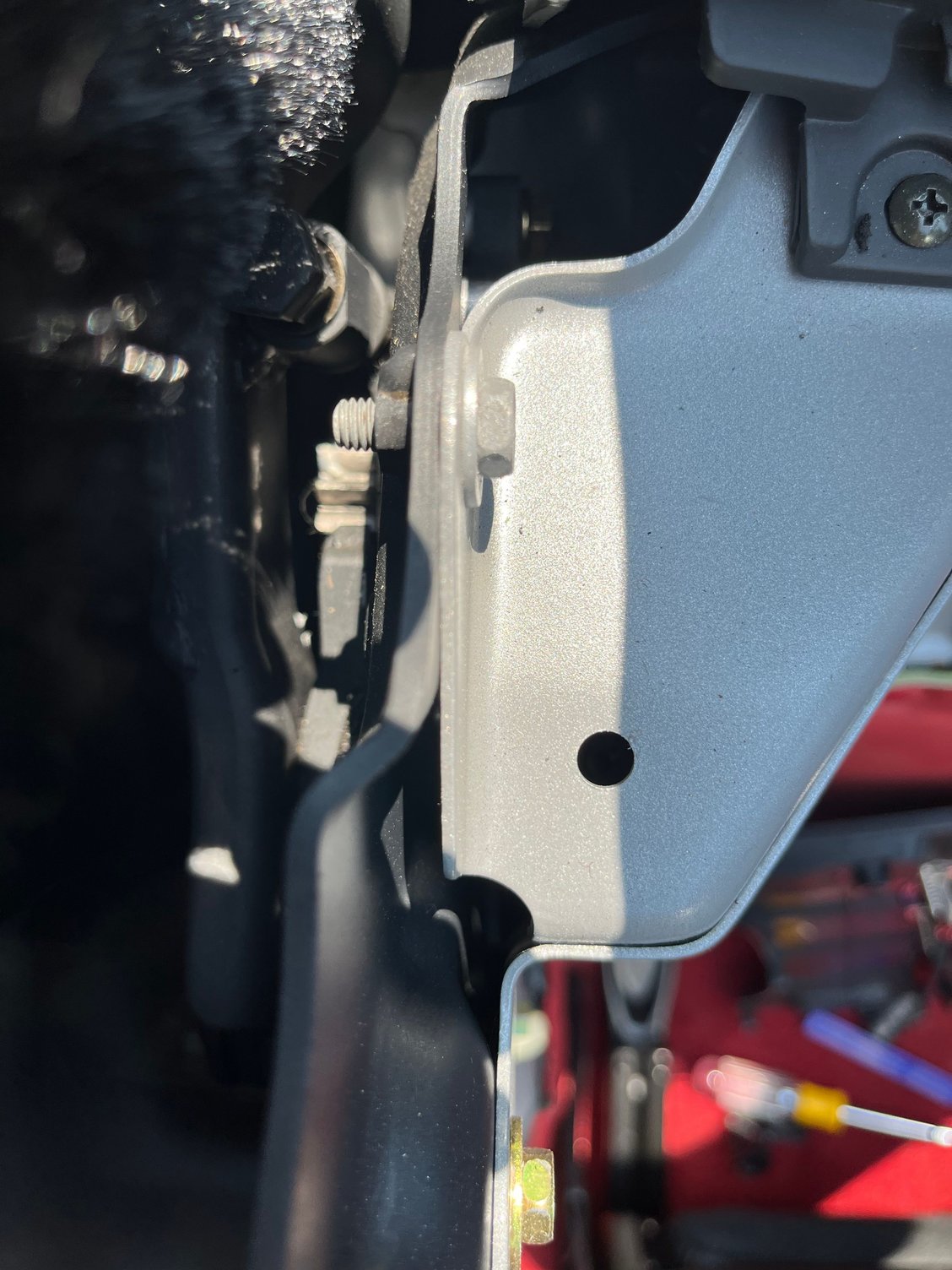

I just installed on my '04. Didn't take a lot of photos but a few are below. Probably less than two hours to install the catchers.
i did find that even though my top had been installed and adjusted on another car, it did not automatically fit. I had to remove the trim panels on the hardtop, loosen all bolts on the side latches and follow the directions on pages 5, 6 and 7 of the "Type B" instructions.
This was not an easy or quick process - took two of us another two hours just to adjust.
FWIW, I was quoted a cost of $370 at my local dealer.
Photo 1 - clips on sill trim
'Photo 2 - lower trim - hidden screw
Photo 3 - corner gusset before reshaping
Photo 4 - corner gusset after reshaping
All installed... car is Sebring Silver - top is Silverstone.
