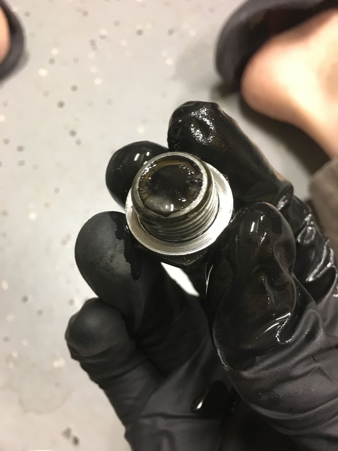

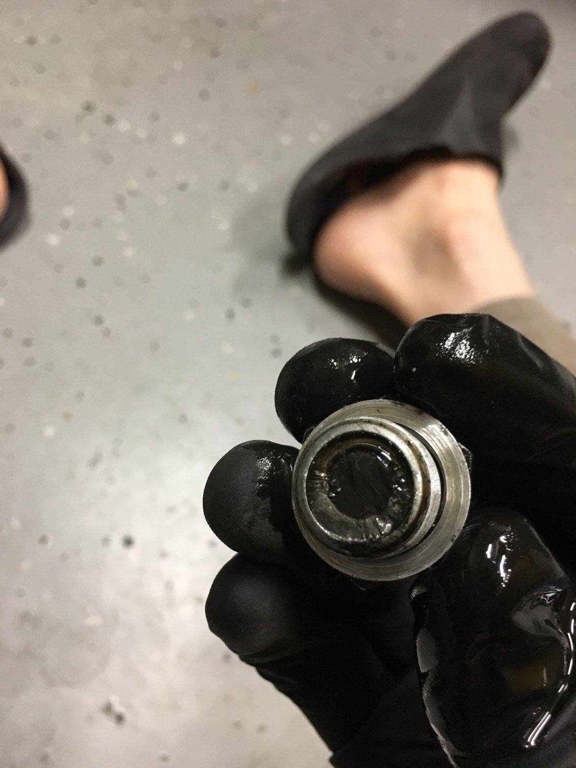

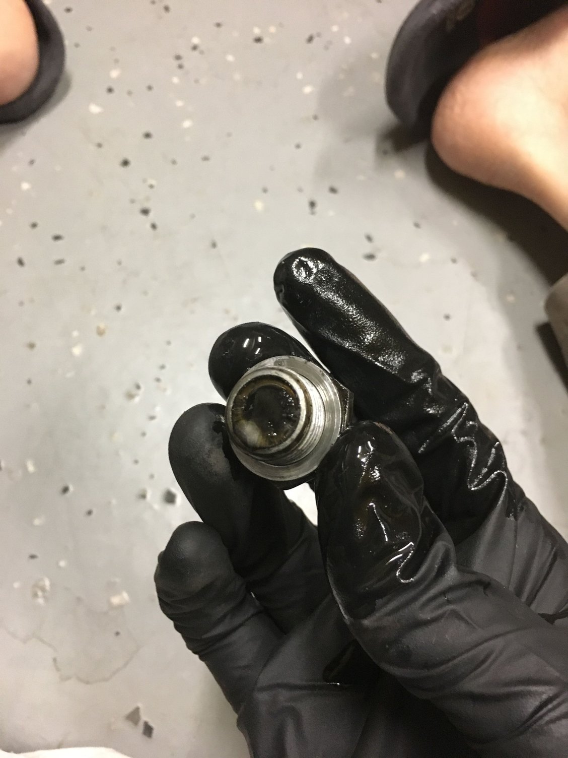

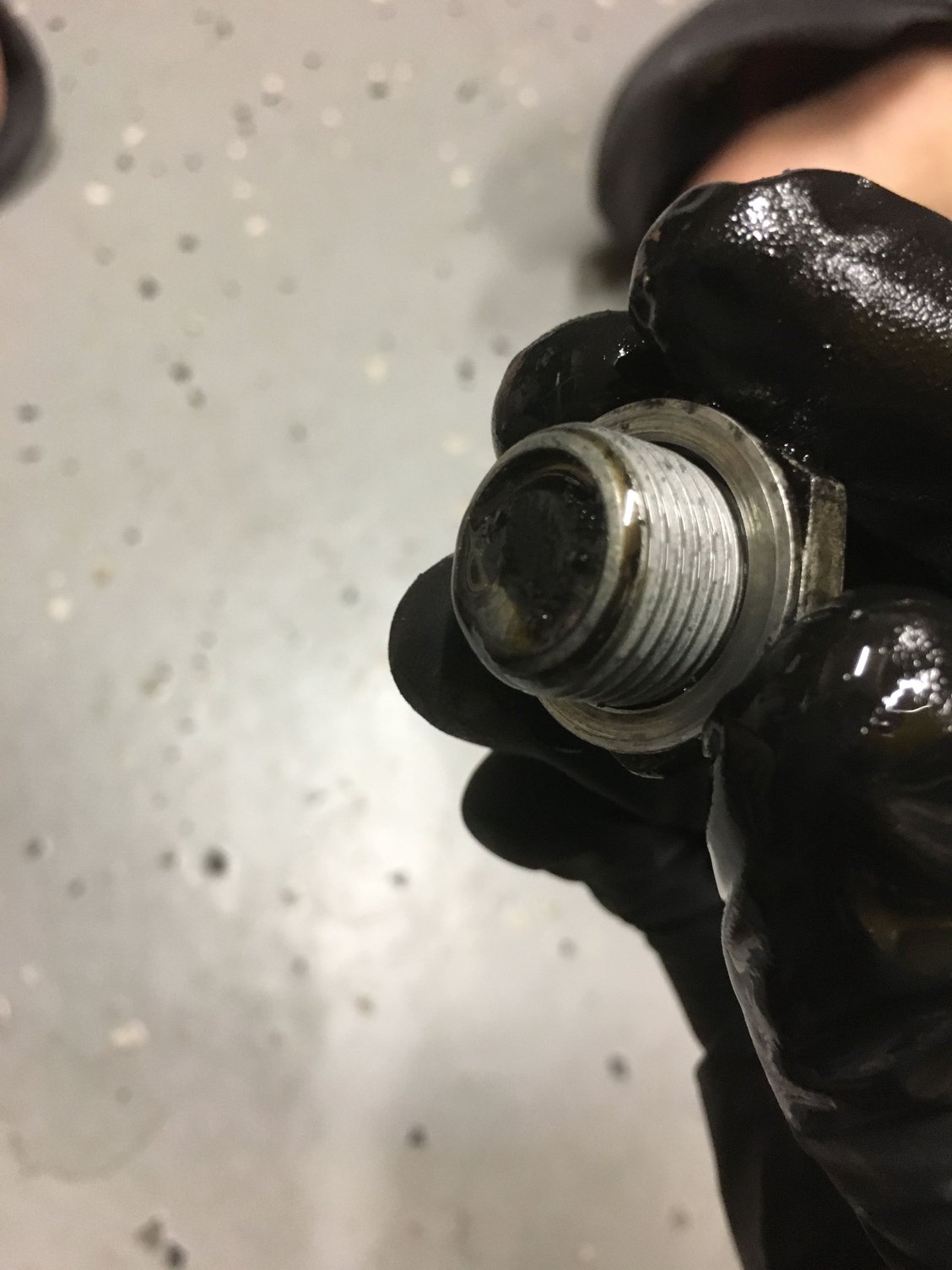

Here are some pics of what I found on the drain bolt

Looks normal to me. But I've only changed my differential oil twice.

Yup that looks normal, I just did my diff fluid on my new to me s2000 , mine looked exactly like that. I used amsoil severe gear 75w-110w , good luck buddy

Drain bolt magnet looks normal.
Drain the Mobil1 75w90 in 35k miles, you'll see what a super clean magnet looks like.
