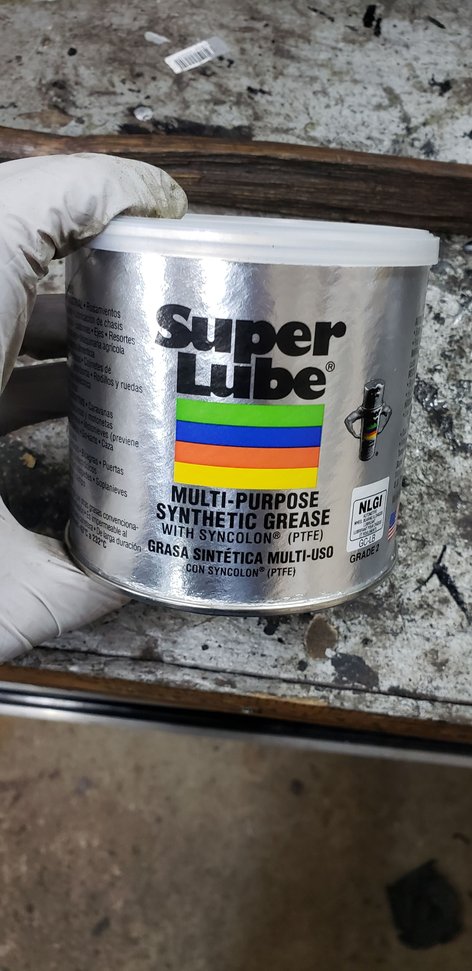

Why re-grease the ball joints? They shouldn't need it unless its been squeezed out or the boots were damaged.
If you do decide to do it...be careful not to use a grease meant for metal/metal sliding parts. There's a plastic bearing in there. I've had luck using "Superlube" PTFE grease or polyurea grease.

I wouldn't use any moly grease (like red n tacky) for ball joints with plastic bearings.
This stuff seems really close to what OEM's use on sealed ball joints.
