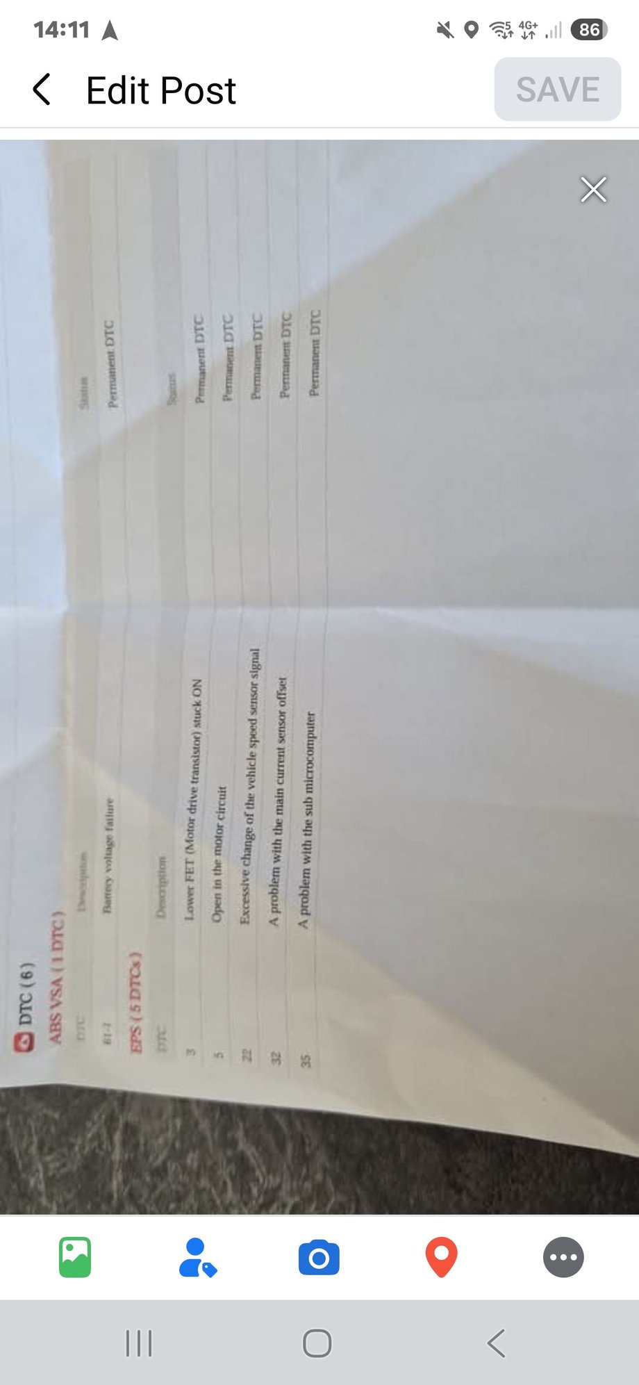

Hey guys,
I parked my s2k up over winter and ran it regular and kept the battery on trickle charge. When the weather was ok I gave a quick run about.
since getting it out for spring the EPS came on intermittent and now stays on
had it read at a diagnostics place last week and the write up still didn't tell me much. Some people are saying torque steer sensor. I'm wanting to get to car meets soon so need to be quick with a fix.
I'm Derbyshire area.

I'll be interested to know what this was and resolution, has just had this issue arise on my car. How did you get the error codes as I don't think OBD2 will read them?

That was the printout that came from the diagnostics place when they plugged it in. Ive been out twice since and my eps light hasn't come on. Typical.

Replaced my EPS module, problem solved.
