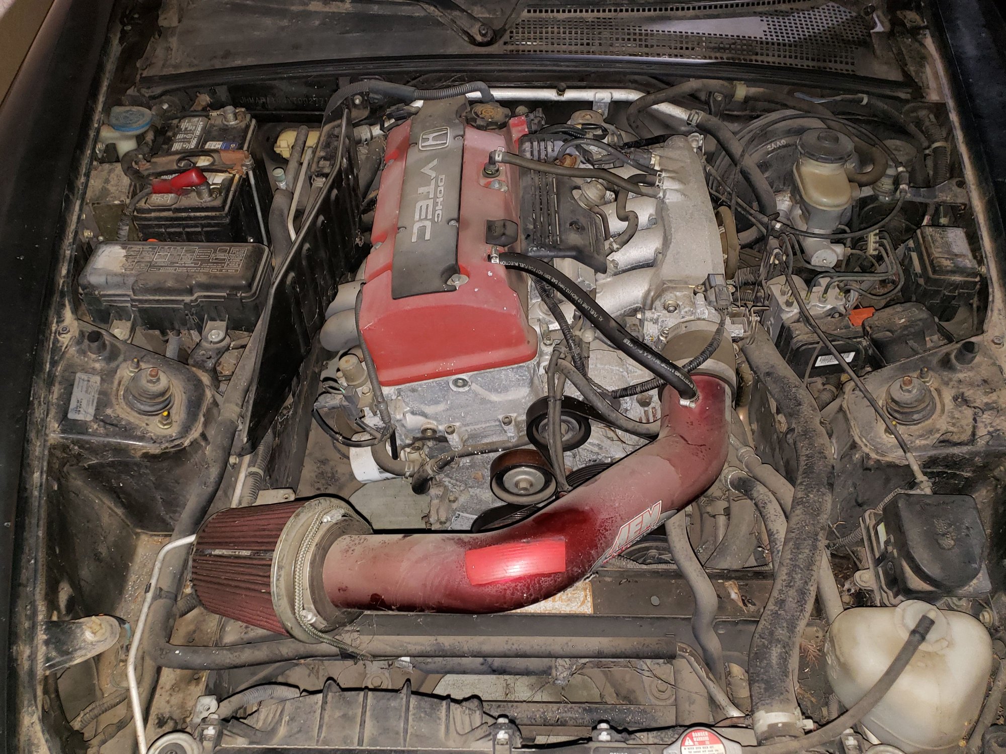

Hey everyone, I'm restoring a 2000 S2K and I need to see what the stock setup looks like. Some reference so I know what is missing and needs to be replaced.
The car belonged to my brother who passed away and it's been sitting in a field for 4 years. I'd like to restore it. I've attached a pic so maybe someone can tell me what I'm missing...
Thanks.

Looks like you just need the stock airbox and a stock header, looks like there’s an aftermarket header on it due to the lack of a heatshield.

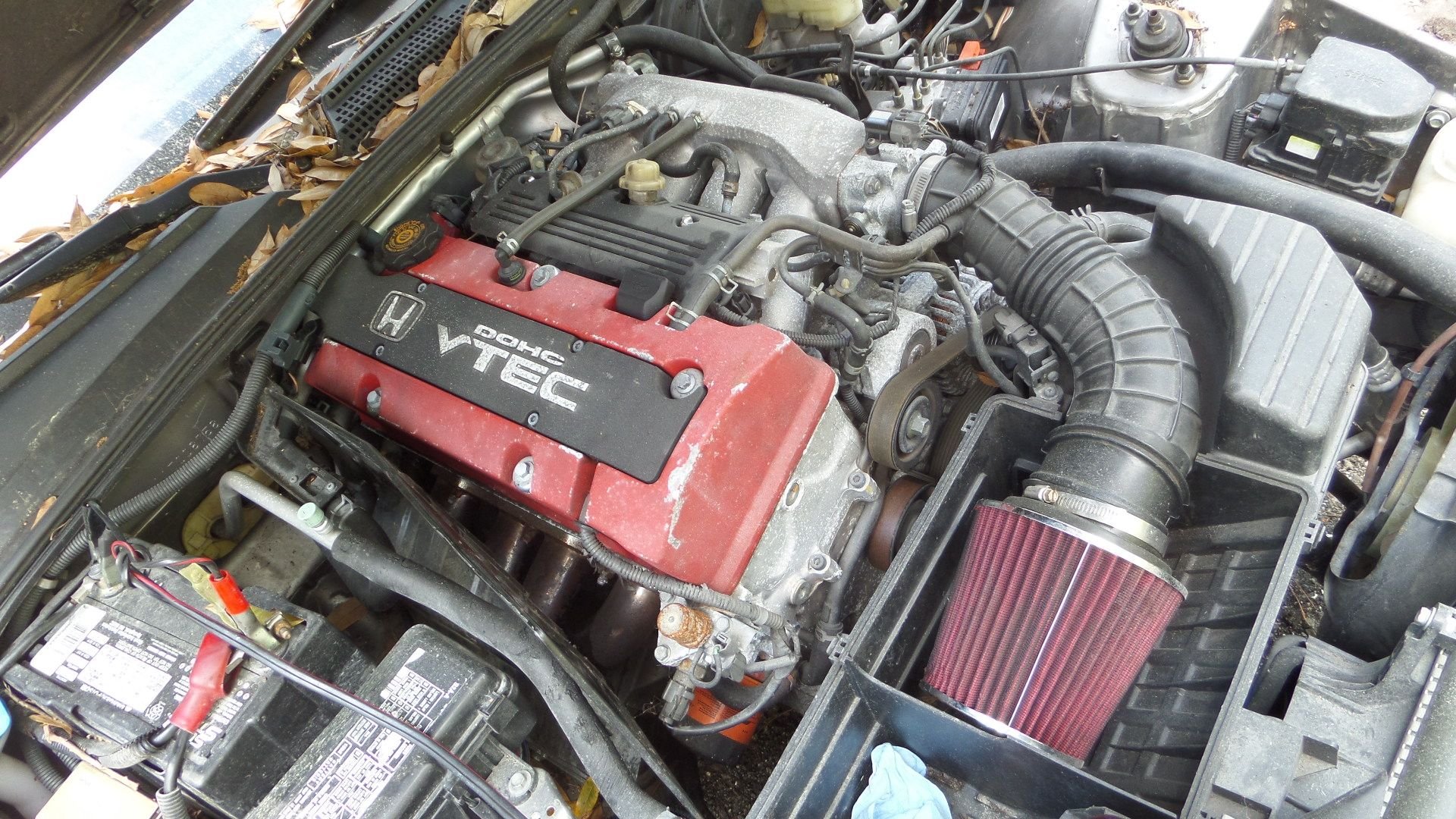

Here are some Pics I have of an 01 (I think) I bought the car for parts for my project, the car was in a rear end crash.

Despite being dirty AF that doesn't look too awful bad.
Does it run?

Actually runs really good. Im in CA., but the headers are CARB approved. The AEM CAI is CARB approved also.
Just cleaned up the engine bay a bit...

Im not too far off then. Man that air box takes up alot of room in front of the engine, I thought I was missing something...

It is missing the air pump injection hoses that run in conjunction with the oem crankcase breather tube that runs off the valvecover. That can happen when you run an aftermarket intake like that. I can't tell 100 percent but the owner may have altered the hoses to keep the air injection system functioning properly, if it wasn't running properly you'd probably see a check engine light so it is probably good.
Just give that baby a good cleaning , change all of the fluids - fuel, oil, brake fluid, clutch fluid, coolant, and air filter cleaning and you should be good to go. When you have time check the cabin air filter, they can build up dirt and dust if not replaced regularly. My condolences for the loss of your brother, was he a member on this site ? All the best, and respect for what you are doing with his car.
