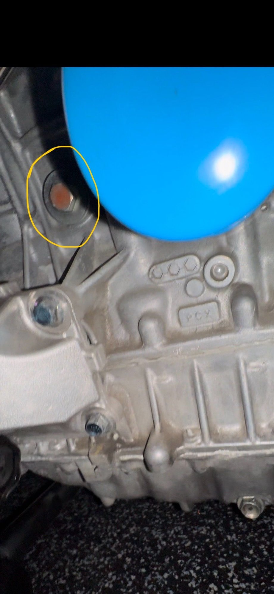

Is the bolt I’ve circled in yellow the engine coolant drain bolt? It looks different from what the manual says is the engine drain bolt. I have a 2009.

Yes that's the correct bolt.
83Nm seems a lot though, don't think I torqued mine anywhere near that.

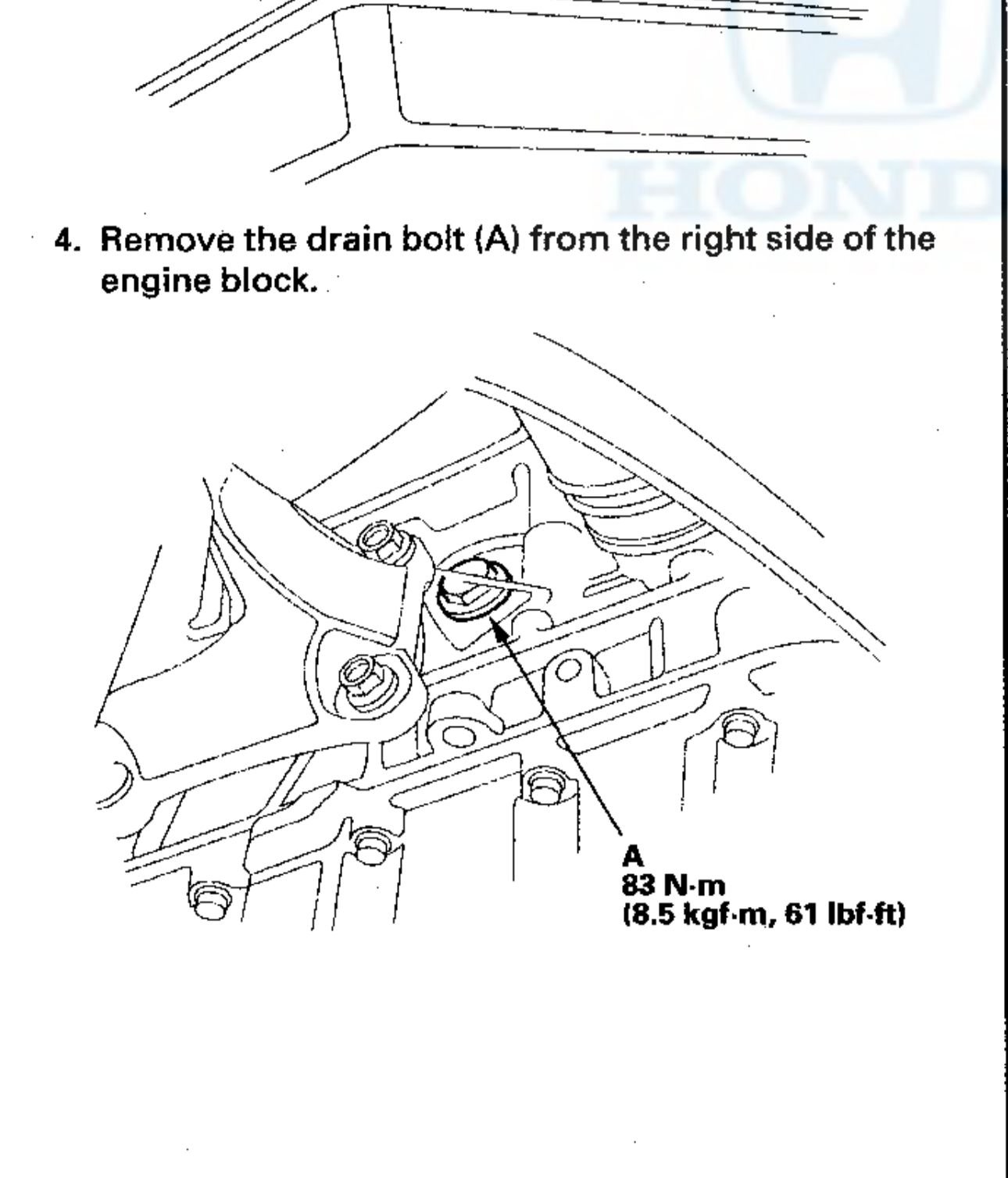

83nm is correct. 61LB-FT
Small amount of hondabond on the threads and new crush washer.

If you drain the radiator completely, very little will come out of that hole.
That hole is also used to install an engine block heater. It’s an OEM part, that allows you to plug the car in and keep it warm. Very useful in extreme cold.

If you remove the bolt, maybe 1/3 Quart or Liter came out. Maybe! Is this worth the hassle?
83 NM is correct. It seems to me that Honda allways gives high torque specs compared to the Suzukis and Kawasakis i worked on, but so far never had a problem. *Knock on Wood*

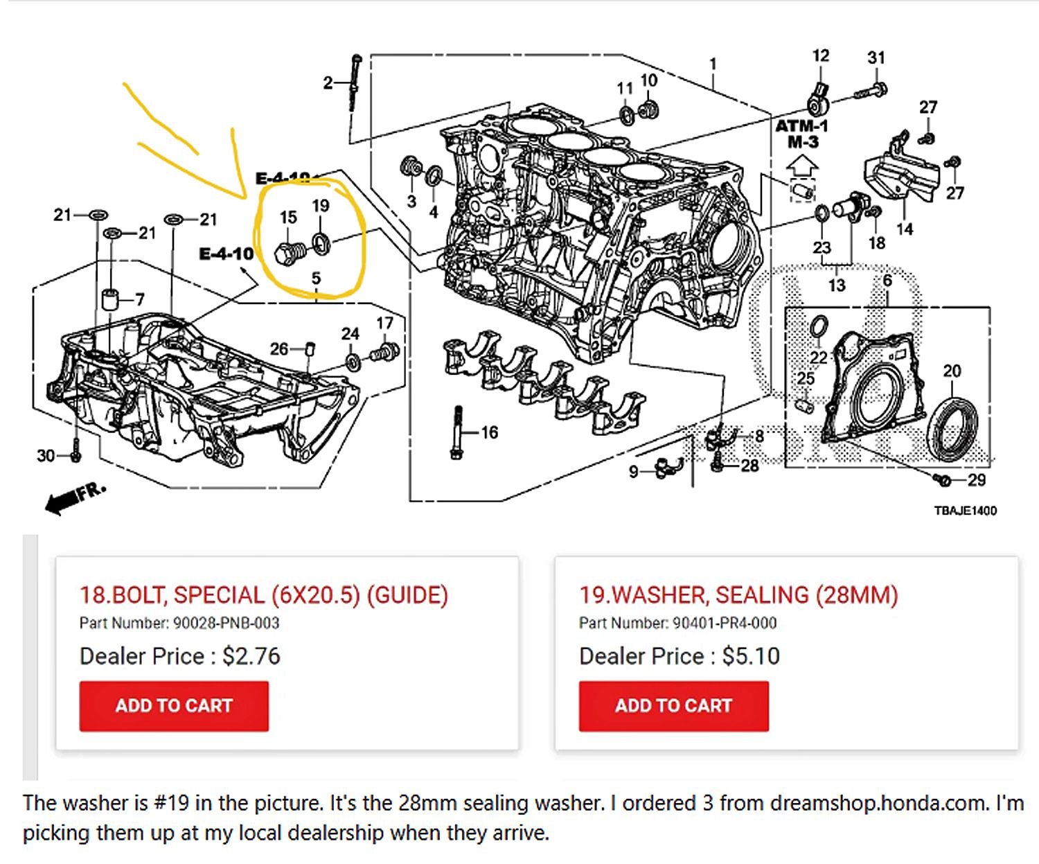

What size is the crush washer?

This is what Google said about a similar bolt on a Civic. Compare the bolt dimensions. It may be the same washer.
If not, you can always sand down the lip scars from the previous torque-down, and it'll prolly be okay for one more use.
