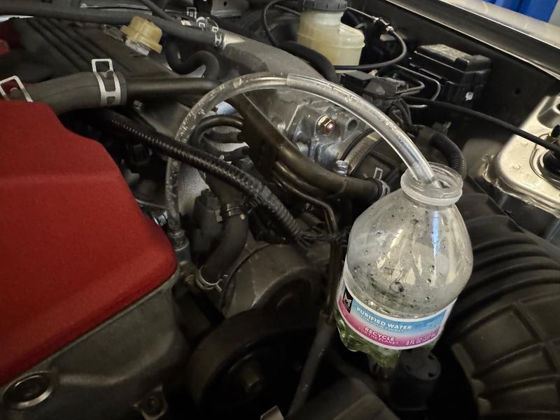

I figured out why my local Honda dealership doesn't remove the bolt on the engine block to drain the coolant. It seems to be impossible to turn off. From under my car that was on my life, I had a straight shot with an extended ratchet. With a ton of force, all I managed to do was round off the bolt head a bit. It's simply not moving. So, forget that idea.
On the plus side, I figured out a way to remove more trapped air from the system. In most of the videos that I watched, people closed the bleeder valve after filling the radiator. I left it open and ran a tube to a water bottle. When I warmed up the car, a ton of air came out of it. I had to empty the bottle a few times as some water came out along with the air. The water is much lighter green. After air stopped coming out of it, I turned off the car. Then some more air came out. I'll let it cool and then repeat the process one more time.

I opend the bolt, it is a BIG hassle. It is best a two man Job (One turning the wrench, one pressing the ratchet and nut firmly into position) with the car on the lift. I will never do this again.
Regarding the bleeding, i prefer the LHT method + opening the Bleeder at the firewall. Have a read: https://www.s2ki.com/forums/s2000-un...y-way-1218970/
