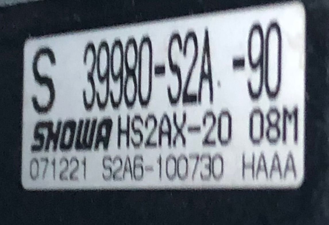

I've attached a (dodgy) picture of the label from mine.
Which if these should I look to match from an eBay part?

EPS UNIT
This Fits Your 2008 Honda
Part Number: 39980-S2A-A05
Supersession(s): 39980-S2A-A04; 39980-S2A-A03; 39980S2AA03; 39980S2AA04
You may be able to find the OE part (Honda didn't make this). New part retails for over $1000 so Ebay would be the place to start.
Got the service manual? Throwing multiple-hundred dollar parts at the car very frequently doesn't fix it.

When you say supersession, do you mean that the A04 won't work? I've found two of those on ebay quite cheap, but no -A05's on there at the moment.
I haven't got the service manual. I have had a quick dig around, but can't see how to get a copy for a 2008 UK model. Any ideas?

Superseded merely indicated the old part number is revoked and this is the current and correct number. Older parts should work.
This is a link to the US/CDA Service Manual. Other than your steering wheel being on the wrong side of the car I can't imagine the trouble shooting of the EPS system will be different.
