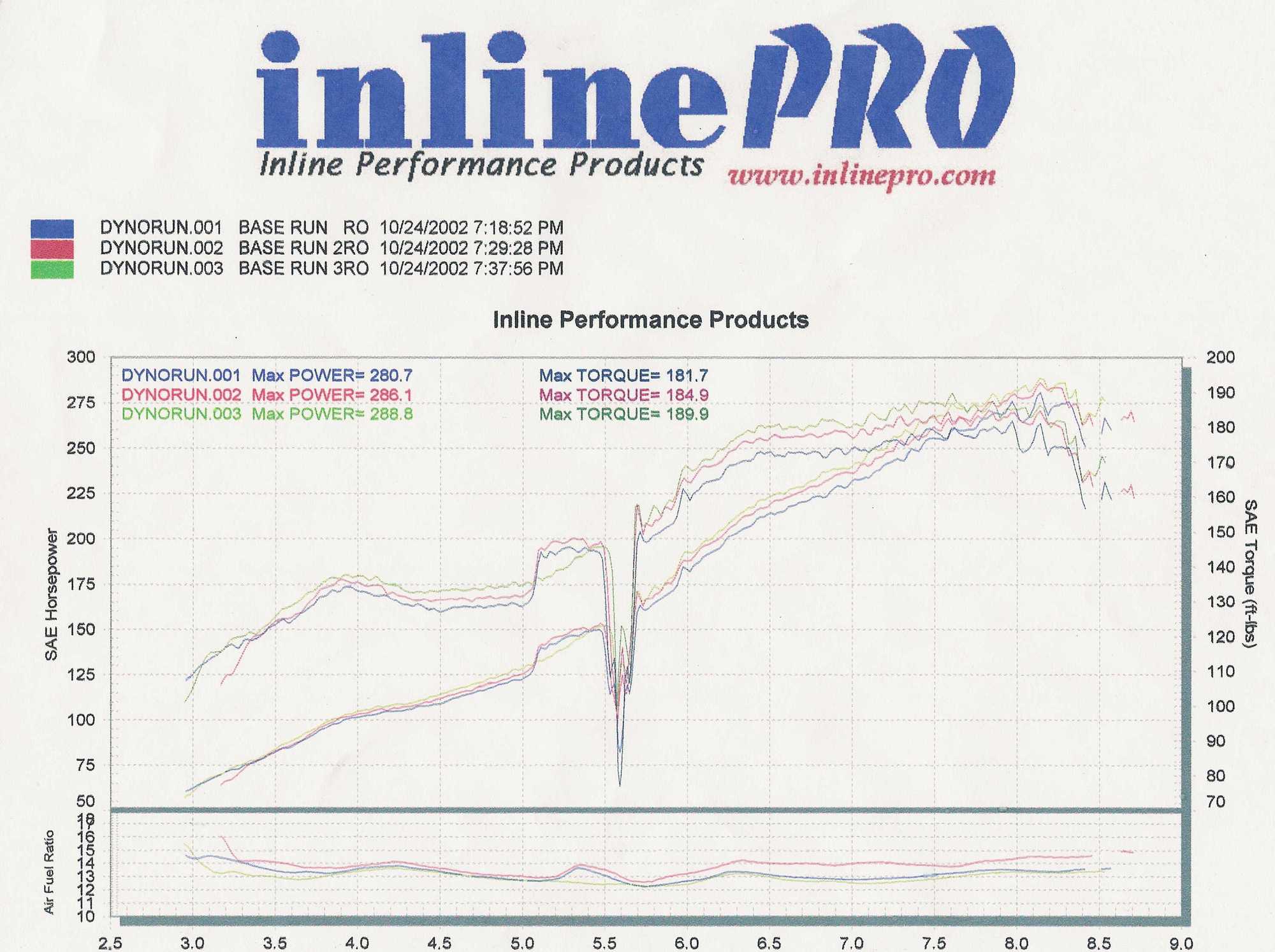

Houston we have a problem. I got home really late last night and now I'm late for work so I'm heading there. I will explain more when I get to the office. Plus I can scan the dyno chart there and post it up. I need your guys help, don't know what's going on. Very big dip at 5500 every run which is killing my power. Timing? Fuel? Don't think my VAFC can trick the ECU with that much fuel being added. Prob going to have to go bigger injectors and SAFC. Any thoughts? I'll post the dyno in like an hour.

I think the part of the problem is that how VAFC adjust fuel.
Correct me if I am wrong, but VAFC adjust MAP sensor signal to change fuel delivery.
If that is so, substracting value isn't problem but adding value will cause problem like modified map sensor reading going postive value thus ECU going little crazy because of it.
That is my theory.
Mike's answer is try increasing fuel pressure or modify by adding adjustment plate to the fuel pressure but like the problem I had before, going to bigger injectors is a must and another fuel management other than VAFC. Because VAFC just won't get the job done right.
Mike looks like you need to knock on the door of AEM for another sponsorship, and maybe include me in there.
Another way no-one tried but should is adding another injectors working when approaching vtec. That way you can easily keep the drivability at low rpm with stock injectors and don't worry at higher rpm where more fuel delivery is required. This would be much simpler than standalone and cheaper. But I am just talking that out of my ass, so I can be so wrong.

Here's the dyno. Trevor, any thoughts?
A/F seems to be ok.
