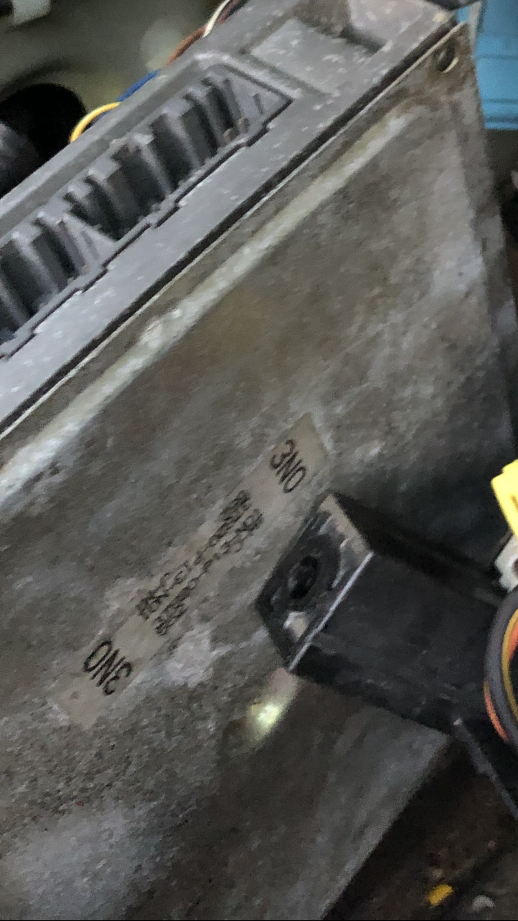

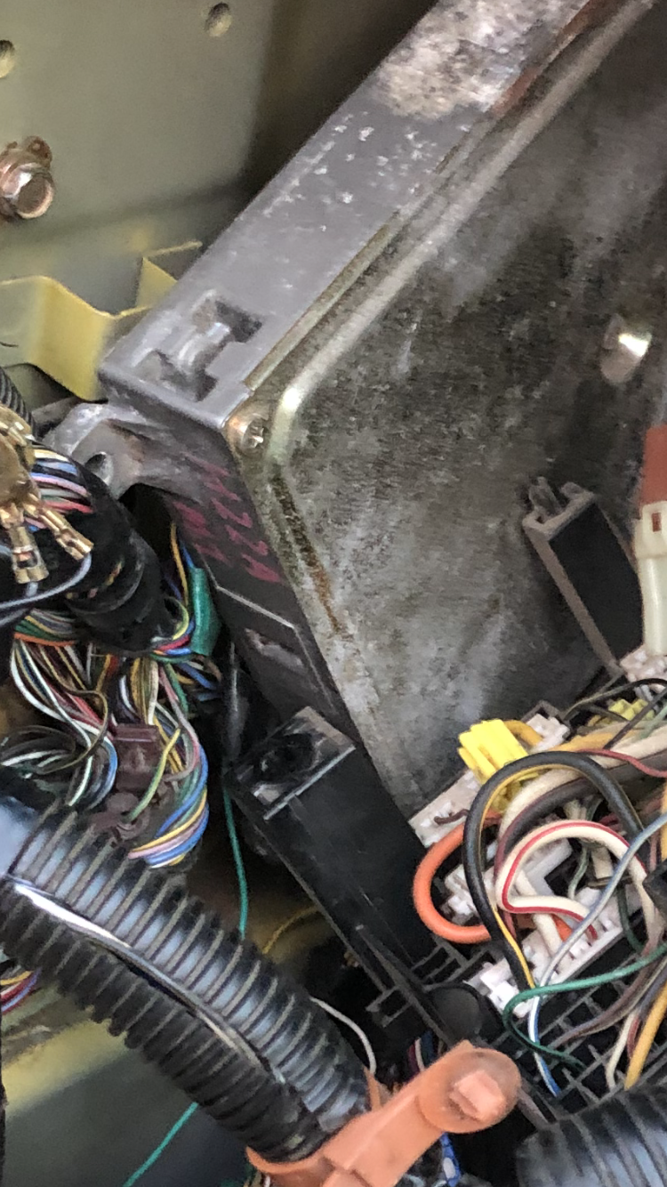

Now here is where it starts to get a little weird, the car supposedly has a "modified low compression setup" engine from an AP2 (160PSI in each cylinder) and while striping it down we found out that its hooked up to an H23A ECU...
Has anyone ever heard of this being done?
Best case scenario in my head is that the guy who had it turboed parted out all the turbo bits including the original ECU and put it in as a placeholder or that it might even work??
Worse case scenario is that it might have been turboed but that the engine is completely shot, that the guy put in a H23 ECU in it so that it wouldn't be able crank and that he'd able to pass it off as an electrical issue seeing as the car has some melted wires
Either way, the interior was stripped in a few hours, dash, seats and every single piece of carpet, some of which had melted and glued to the floor. We're planning on getting up and running, passing the inspections and then depending on if the car actually has a low comp block either turbo it again, or in the case that its shot, swap it out for something bigger because everyone likes a good old LS swap right
On a side note, my brother also has a 2008 AP2 that's in working condition so we could easily test for the ECU if we have too.

My guess is someone took the AP1 ECU or whatever standalone was in it and kept or sold it.
The H22 OBD2 ECU on its own is pretty useless, cant be chipped or flashed, has an immobilizer. Highly doubt it was being used to run an F22C.
H swaps in other OBD2 cars are easier done by using an OBD1 ECU; More than likely they had an OBD2 H22 ECU laying around from a previous swap and threw it in there expecting insurance to be none the wiser.
