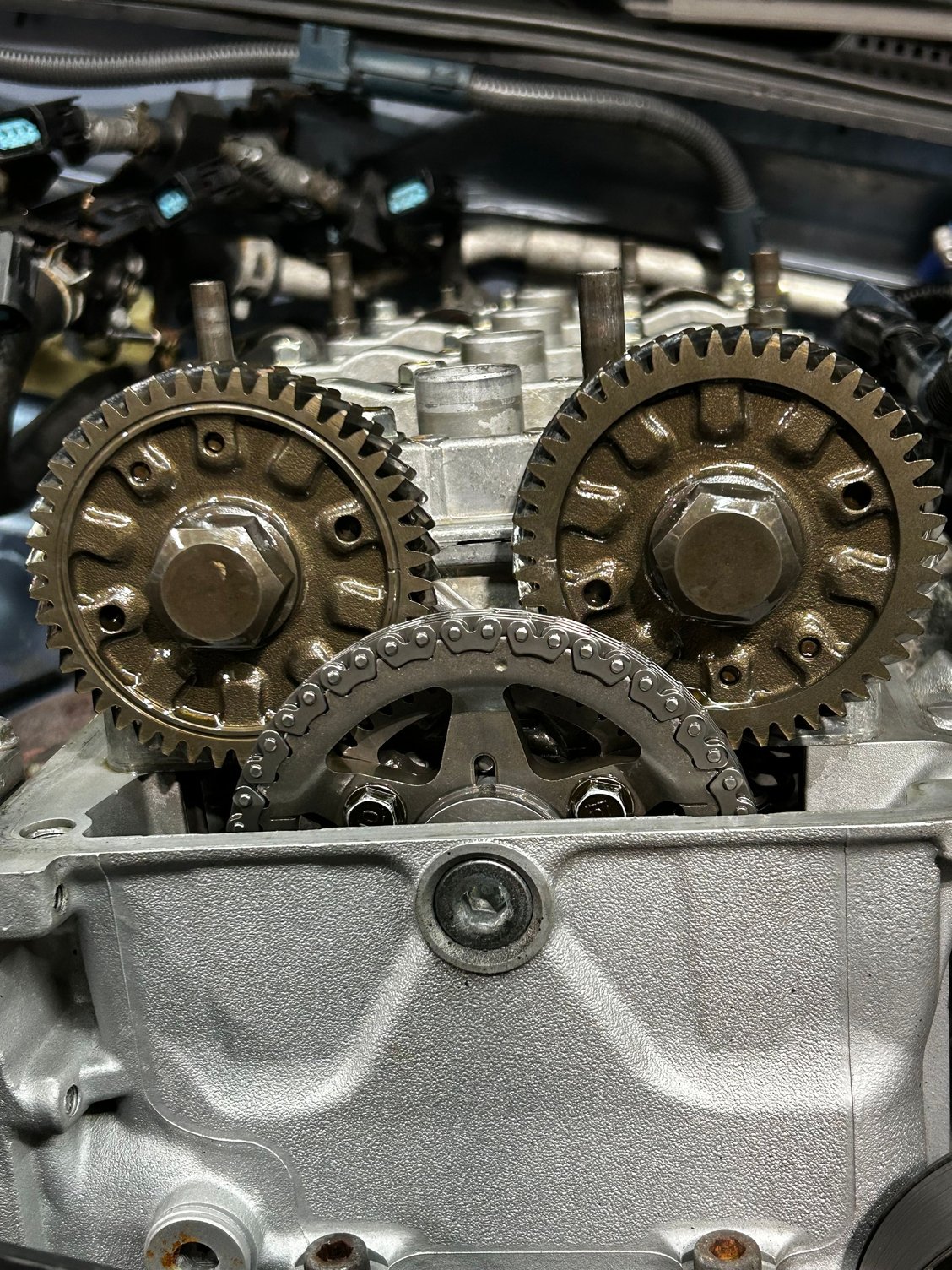

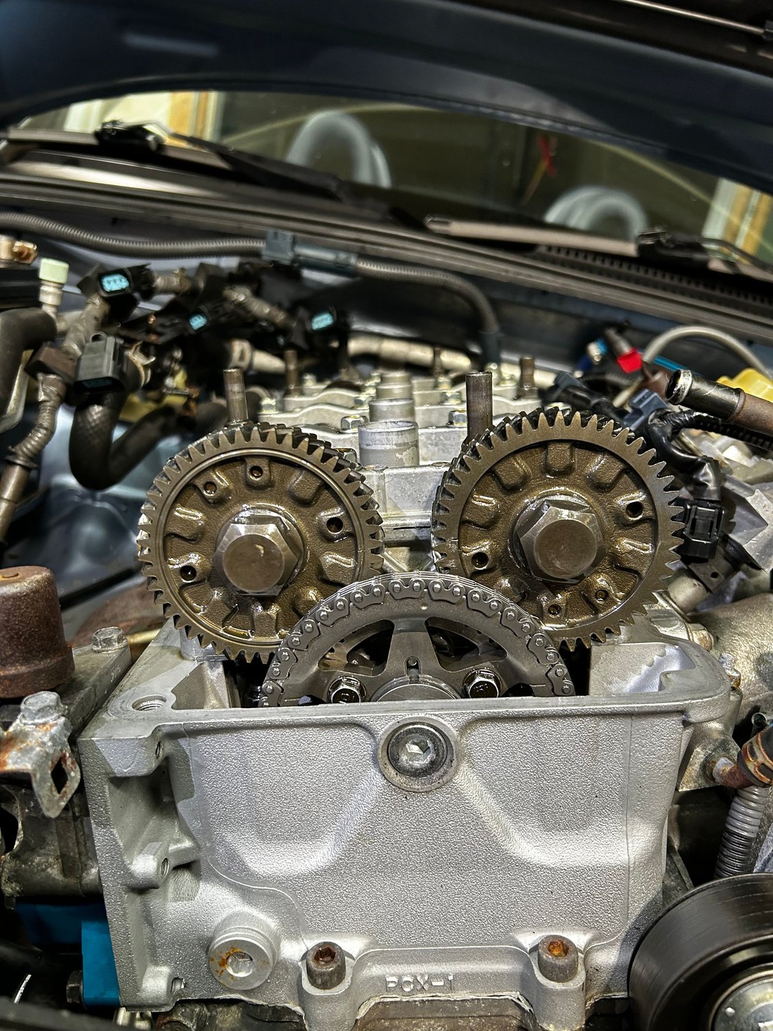

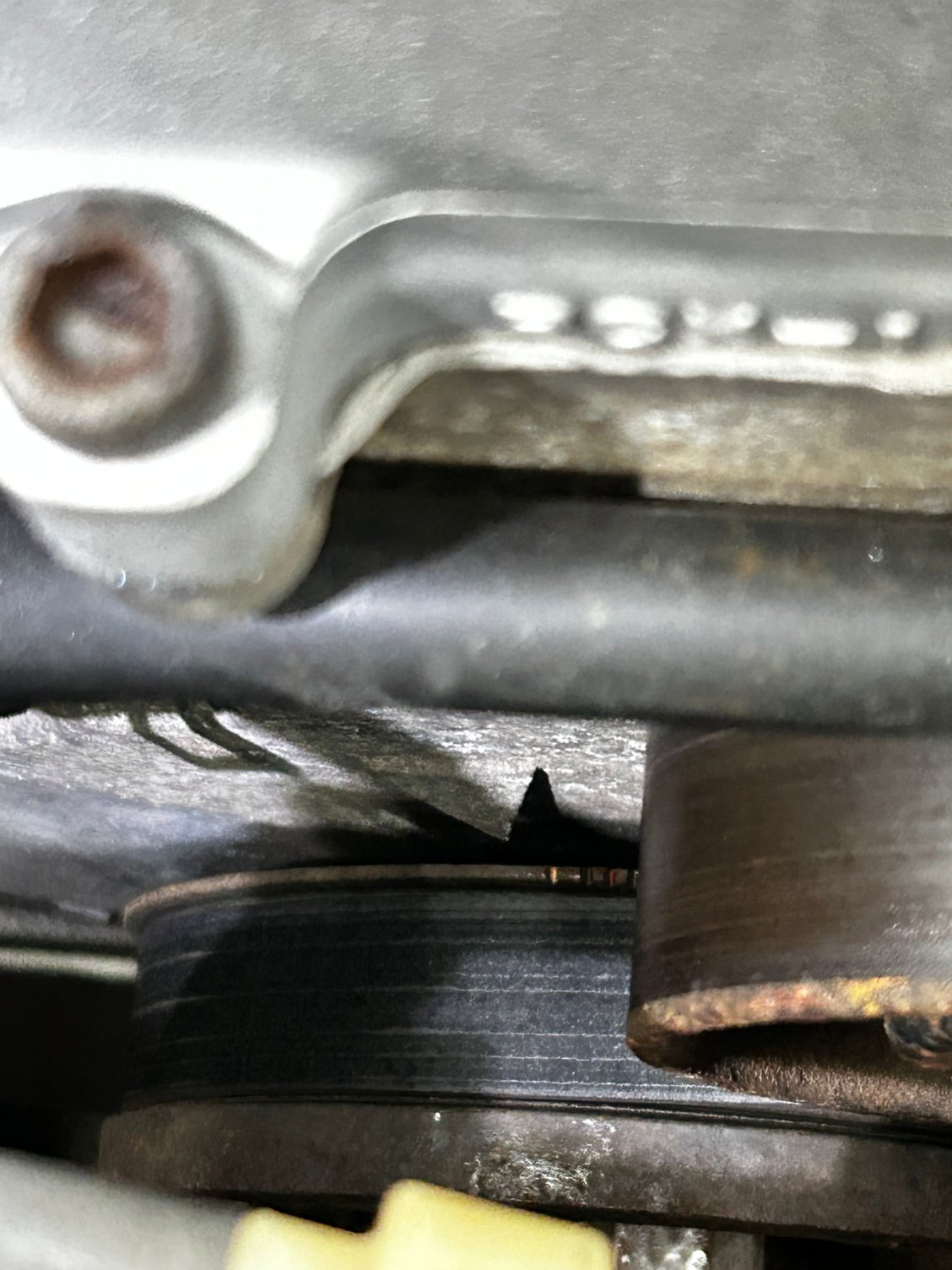

At first I thought maybe I spun a bearing but when I drained the oil there was no shavings , Oil filter as well. I have had the car started multiple times since then and figured it would have seized by now etc especially since I drove it about 10 minutes home after the incident. I did a compression test came back 220 , 225 ,227, 230. Did it multiple times to insure readings. I have 107k miles and I have only owned it for about 500 miles. Previous owner did Timing chain and tensioner. Could my timing jumped a tooth and now is making the car run like garbage? Could it maybe be an injector or coil going and not throwing a check engine light ? Here are some photos of the timing. Two sets of photos first is when cams are lined up and crank is off by a bit and second is crank lined up and then cams look off on intake side. The car still starts right up and idles normal. Top end was definitely rebuilt at some point as well for some reason or another. Looking for some options on what it could be and if it was the timing being off if I could adjust it by 1 tooth without taking it all apart. Thanks in advance.

Timing looks fine. The compression numbers also indicate the cam timing is fine.

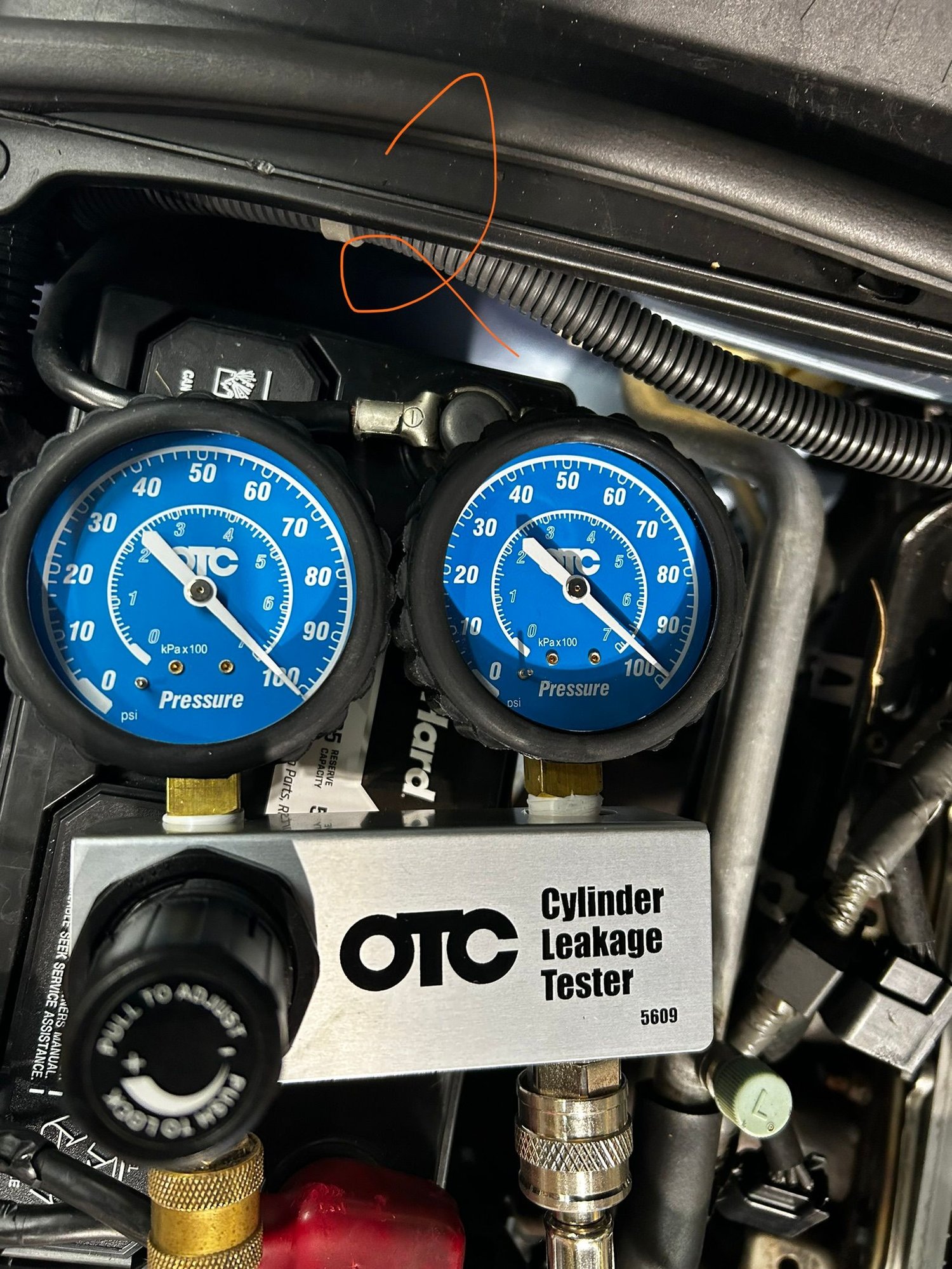

Results I got from doing a leakdown test today. Still have no idea what could be causing the car these issues. Going to see if I can check maybe a bad coil or injector and its not throwing a check engine code.
