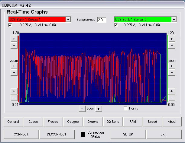

This is a graph of the 2 sensors. Do you see a problem? The green is the sensor that caused the CEL.
Jim

Pull your o2 sensor from your cat and inspect it. It might need to be replaced
