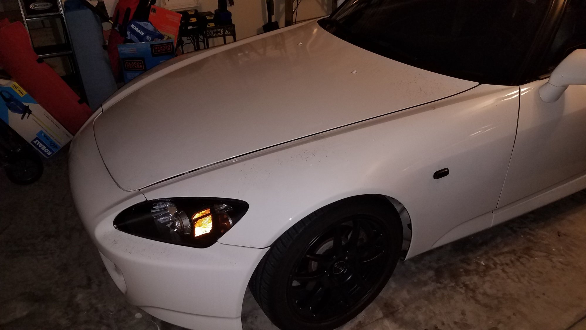

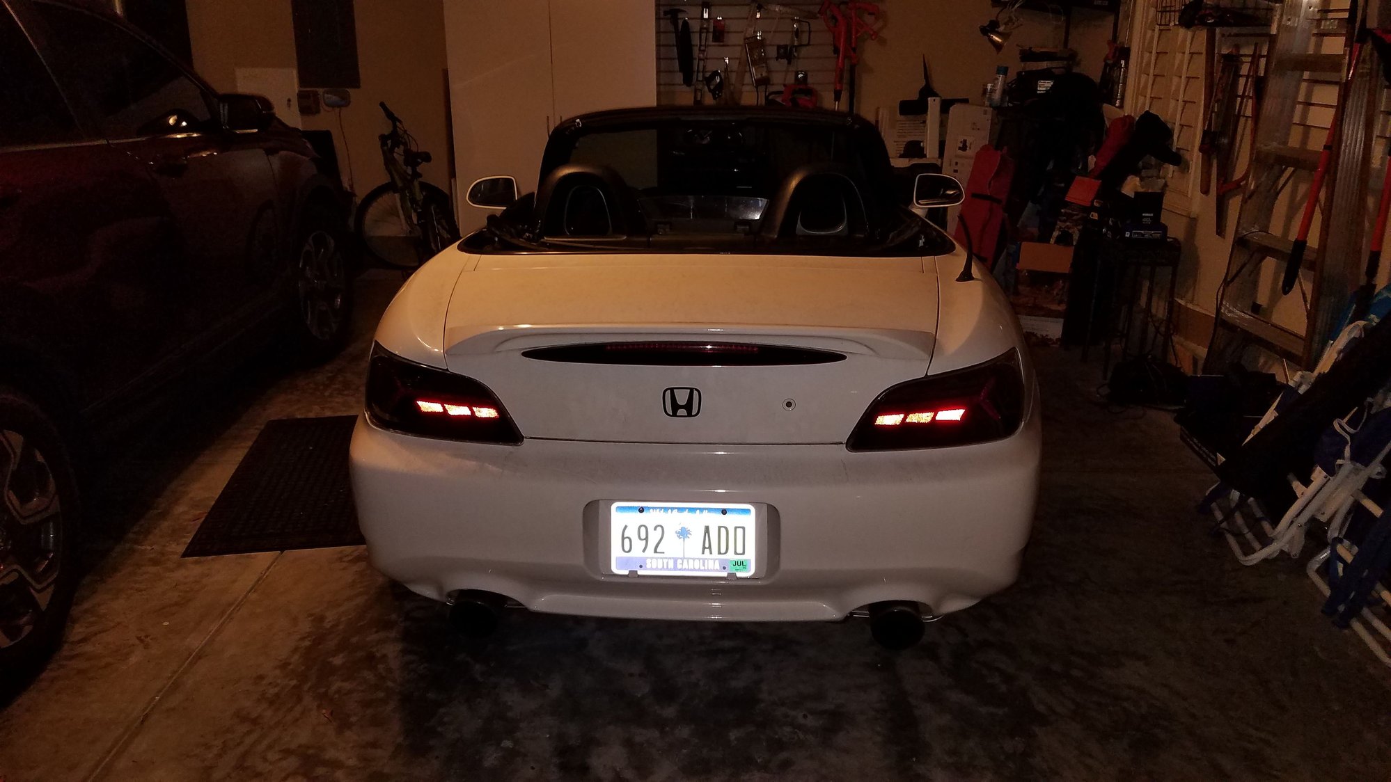

Hello all, I have a 2005 white s2k, first one 100000 miles, I've owned porsches , WRX STI, various sports cars...s2k EASY favorite, low matinence, vtec is too fun lol, just gorgeous looking car. I had a 2012 Porchse boxster S black edition top 186 mph( last year the Boxster got the Carrera engine, I get just as many complements on the s2k, one guy followed me in a Walmart parking lot taking a video lol
