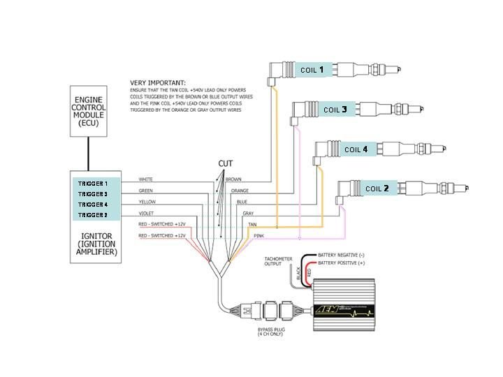

When I finally get my engine back together and the turbo installed, this is how I'm goind to wire up my CD2I:

u tal, what year are your honda motorcycle coils from?
My harness has 4 black and red-blue, yellow, red-yellow wires in the harness. I am going to wire as above diagram ( or in series) with the black wires hook up to 540+V.

Originally Posted by yakrat,Nov 29 2004, 09:03 PM
H9k, you were correct in saying that one capacitor needs to recharge while the other one discharges. Since the S2000 fires in the order 1-3-4-2, pink connects to #1 and #4 and tan connects to #2 and #3.

are you guys sure the s2k fires 1-3-4-2? I thought it fired 1-4-3-2 because thats the order of cylinders being set TDC when you do the valve adjustment.

1-3-4-2 is the correct firing order.

The diagram that I posted on page one also works fine. If you use fperra's diagram, be sure to note the change in ignition inputs on the left. Here's my diagram again for reference:
